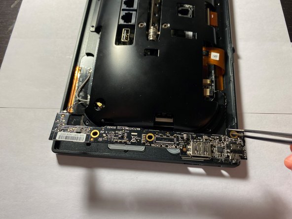

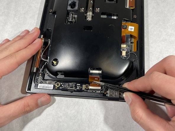

  5. Cisco Meraki MC74-HW USB and Headphone Jack Inputs Board Replacement, USB and Headphone Jack Inputs Board: crwdns2935265:05crwdnd2935265:01crwdnd2935265:02crwdne2935265:0 Cisco Meraki MC74-HW USB and Headphone Jack Inputs Board Replacement, USB and Headphone Jack Inputs Board: crwdns2935265:05crwdnd2935265:02crwdnd2935265:02crwdne2935265:0
    • Disconnect the ribbon cable on the board using a pair of reverse tweezers.
    • Electronic ribbons are very fragile, so pull slowly to disconnect them.

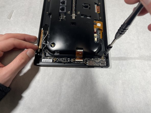

  6. Cisco Meraki MC74-HW USB and Headphone Jack Inputs Board Replacement: crwdns2935265:06crwdnd2935265:01crwdnd2935265:03crwdne2935265:0 Cisco Meraki MC74-HW USB and Headphone Jack Inputs Board Replacement: crwdns2935265:06crwdnd2935265:02crwdnd2935265:03crwdne2935265:0 Cisco Meraki MC74-HW USB and Headphone Jack Inputs Board Replacement: crwdns2935265:06crwdnd2935265:03crwdnd2935265:03crwdne2935265:0
    • Remove the three 2 mm screws holding the USB and headphone jack inputs board using a JIS #00 screwdriver.
    • Carefully lift the board until you have clear access to the electronic connector.

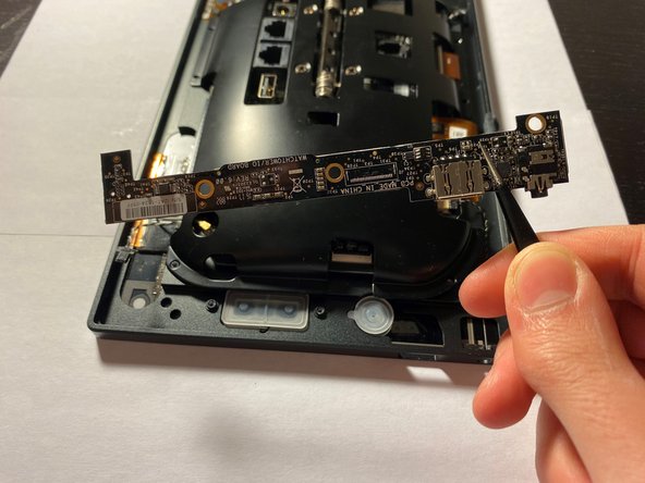

  7. Cisco Meraki MC74-HW USB and Headphone Jack Inputs Board Replacement: crwdns2935265:07crwdnd2935265:01crwdnd2935265:02crwdne2935265:0 Cisco Meraki MC74-HW USB and Headphone Jack Inputs Board Replacement: crwdns2935265:07crwdnd2935265:02crwdnd2935265:02crwdne2935265:0
    • Disconnect the electronic connector on the board using a pair of reverse tweezers.
    • Carefully lift the board to remove it from the device.
