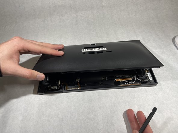

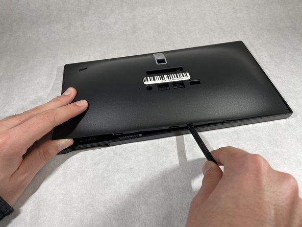

    • Insert a plastic spudger between the back housing cover and the sensor cover piece.
    • Work your way slowly around the edges of the device until all the clips have been unclipped.
    • Do not insert any tool recklessly into the device or you might damage wires and connections.
  4. Cisco Meraki MC74-HW Sensor Cover Replacement: crwdns2935265:04crwdnd2935265:01crwdnd2935265:02crwdne2935265:0 Cisco Meraki MC74-HW Sensor Cover Replacement: crwdns2935265:04crwdnd2935265:02crwdnd2935265:02crwdne2935265:0
    • Separate the back housing cover from the device completely.

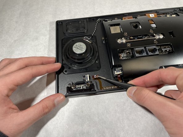

  5. Cisco Meraki MC74-HW Sensor Cover Replacement, Phone Sensor: crwdns2935265:05crwdnd2935265:01crwdnd2935265:02crwdne2935265:0 Cisco Meraki MC74-HW Sensor Cover Replacement, Phone Sensor: crwdns2935265:05crwdnd2935265:02crwdnd2935265:02crwdne2935265:0
    • Disconnect the ribbon from the phone sensor board using a pair of reverse tweezers.
    • Electronic ribbons are very fragile, so pull slowly to disconnect them.

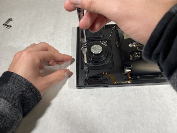

  6. Cisco Meraki MC74-HW Sensor Cover Replacement: crwdns2935265:06crwdnd2935265:01crwdnd2935265:03crwdne2935265:0 Cisco Meraki MC74-HW Sensor Cover Replacement: crwdns2935265:06crwdnd2935265:02crwdnd2935265:03crwdne2935265:0 Cisco Meraki MC74-HW Sensor Cover Replacement: crwdns2935265:06crwdnd2935265:03crwdnd2935265:03crwdne2935265:0
    • Remove the two 1.2 mm screws holding the phone sensor using a Phillips #0 screwdriver.
    • Carefully lift the phone sensor to remove it from the device.

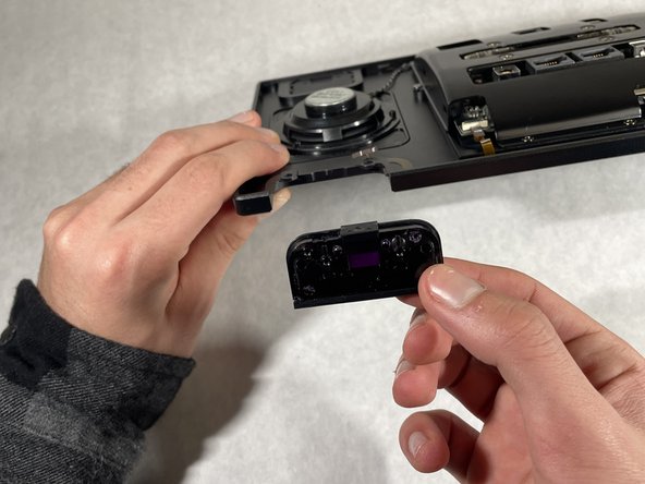

  7. Cisco Meraki MC74-HW Sensor Cover Replacement, Sensor Cover: crwdns2935265:07crwdnd2935265:01crwdnd2935265:03crwdne2935265:0 Cisco Meraki MC74-HW Sensor Cover Replacement, Sensor Cover: crwdns2935265:07crwdnd2935265:02crwdnd2935265:03crwdne2935265:0 Cisco Meraki MC74-HW Sensor Cover Replacement, Sensor Cover: crwdns2935265:07crwdnd2935265:03crwdnd2935265:03crwdne2935265:0
    • Remove the two 1.2 mm screws using a Phillips #0 screwdriver.
    • Remove the sensor cover.
