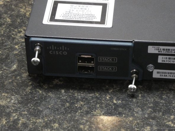

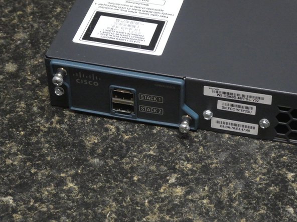

  3. Cisco Catalyst 2960-S Series Network Switch Fan Replacement, Remove Stack Module or Blank Cover: crwdns2935265:03crwdnd2935265:01crwdnd2935265:03crwdne2935265:0 Cisco Catalyst 2960-S Series Network Switch Fan Replacement, Remove Stack Module or Blank Cover: crwdns2935265:03crwdnd2935265:02crwdnd2935265:03crwdne2935265:0 Cisco Catalyst 2960-S Series Network Switch Fan Replacement, Remove Stack Module or Blank Cover: crwdns2935265:03crwdnd2935265:03crwdnd2935265:03crwdne2935265:0
    • Your switch will have either a stacking module or blank cover at the back.
    • Loosen the two thumbscrews (using your screwdriver with the Phillips bit to assist if they are tight)
    • Using both loose screws, gently but firmly pull the module out of its slot.

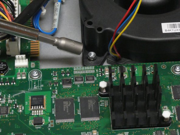

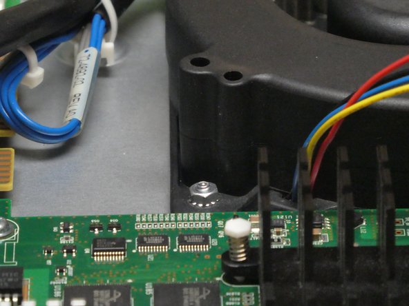

    • Note the two nuts securing the fan assembly to the chassis from above.
  7. Cisco Catalyst 2960-S Series Network Switch Fan Replacement, Unscrew nuts and remove Fan Assembly: crwdns2935265:07crwdnd2935265:01crwdnd2935265:03crwdne2935265:0 Cisco Catalyst 2960-S Series Network Switch Fan Replacement, Unscrew nuts and remove Fan Assembly: crwdns2935265:07crwdnd2935265:02crwdnd2935265:03crwdne2935265:0 Cisco Catalyst 2960-S Series Network Switch Fan Replacement, Unscrew nuts and remove Fan Assembly: crwdns2935265:07crwdnd2935265:03crwdnd2935265:03crwdne2935265:0
    • Using the 1/4 socket bit, remove the two nuts securing the fan assembly.
    • Take care to prevent the nut closest to the Power Supply from being knocked near the internals of the Power Supply.

  11. Cisco Catalyst 2960-S Series Network Switch Fan Replacement, Secure the Fan to the chassis: crwdns2935265:011crwdnd2935265:01crwdnd2935265:03crwdne2935265:0 Cisco Catalyst 2960-S Series Network Switch Fan Replacement, Secure the Fan to the chassis: crwdns2935265:011crwdnd2935265:02crwdnd2935265:03crwdne2935265:0 Cisco Catalyst 2960-S Series Network Switch Fan Replacement, Secure the Fan to the chassis: crwdns2935265:011crwdnd2935265:03crwdnd2935265:03crwdne2935265:0
    • Since the nuts may not be magnetic, start with the nut closest to the Power Supply. Position it on top of the bolt as closely to flat as possible, and use the socket bit to screw the nut in and only mildly tighten.
    • This might take a few attempts. The nut may bounce away. Remove the Fan Assembly to retrieve the nut and try again until you are able to get it secured.
    • Secure the other side of the fan using the other nut.

  15. Cisco Catalyst 2960-S Series Network Switch Fan Replacement, Install Stack Module or Cover: crwdns2935265:015crwdnd2935265:01crwdnd2935265:03crwdne2935265:0 Cisco Catalyst 2960-S Series Network Switch Fan Replacement, Install Stack Module or Cover: crwdns2935265:015crwdnd2935265:02crwdnd2935265:03crwdne2935265:0 Cisco Catalyst 2960-S Series Network Switch Fan Replacement, Install Stack Module or Cover: crwdns2935265:015crwdnd2935265:03crwdnd2935265:03crwdne2935265:0
    • Insert the Module into its slot in the same orientation that it originally was.
    • Do not use a screwdriver. Hand tighten the screws to secure the Module or Cover into place.
