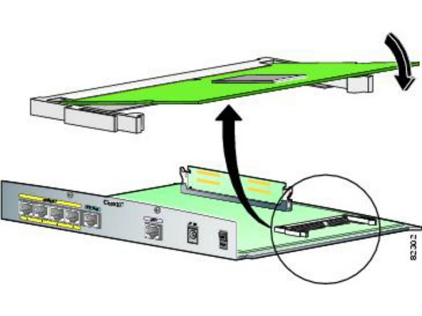

  5. Cisco 878 Router StrataFlash Memory module Replacement/Upgrade, Remove  StrataFlash Memory module: crwdns2935265:05crwdnd2935265:01crwdnd2935265:03crwdne2935265:0 Cisco 878 Router StrataFlash Memory module Replacement/Upgrade, Remove  StrataFlash Memory module: crwdns2935265:05crwdnd2935265:02crwdnd2935265:03crwdne2935265:0 Cisco 878 Router StrataFlash Memory module Replacement/Upgrade, Remove  StrataFlash Memory module: crwdns2935265:05crwdnd2935265:03crwdnd2935265:03crwdne2935265:0
    • 1. Place your fingers on the levers at the two sides of the slot, and push open.
    • 2. Firmly pull the release lever away from the module until the module pops up.
    • 3. You can then remove the module from the module slot.
  6. Cisco 878 Router StrataFlash Memory module Replacement/Upgrade, Installing new module: crwdns2935265:06crwdnd2935265:01crwdnd2935265:02crwdne2935265:0 Cisco 878 Router StrataFlash Memory module Replacement/Upgrade, Installing new module: crwdns2935265:06crwdnd2935265:02crwdnd2935265:02crwdne2935265:0
    • 1. Insert the notched edge of the module into the slot at an angle.
    • 2. Firmly press down the unnotched edge of the module until you hear a click. The indents must be fully in the notches.
