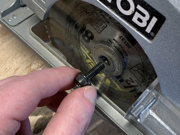

  3. Circular Saw Blade Replacement: crwdns2935265:03crwdnd2935265:01crwdnd2935265:02crwdne2935265:0 Circular Saw Blade Replacement: crwdns2935265:03crwdnd2935265:02crwdnd2935265:02crwdne2935265:0
    • Once loosened, continue unscrewing the bolt with your fingers and remove it from the saw.

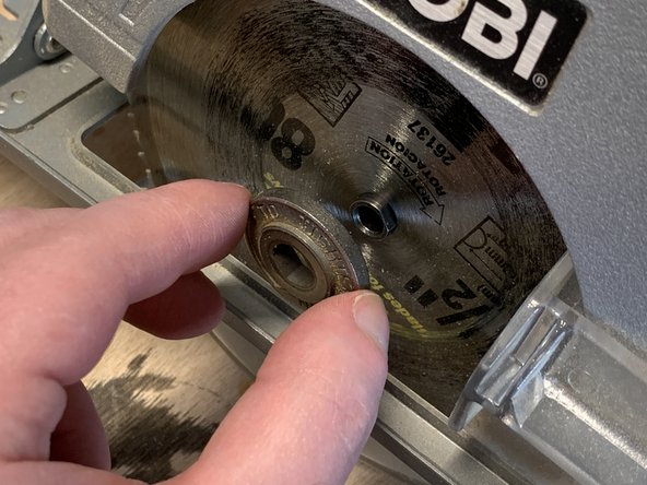

  4. Circular Saw Blade Replacement: crwdns2935265:04crwdnd2935265:01crwdnd2935265:02crwdne2935265:0 Circular Saw Blade Replacement: crwdns2935265:04crwdnd2935265:02crwdnd2935265:02crwdne2935265:0
    • Remove the arbor washer.

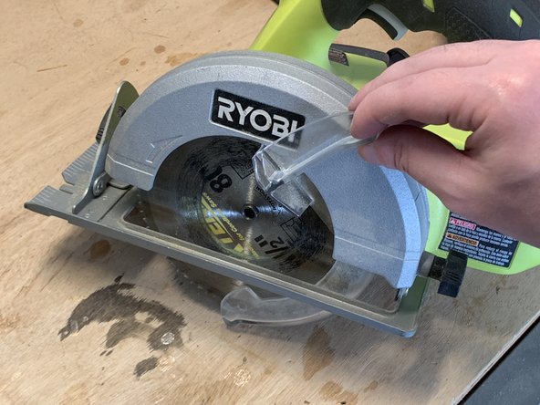

  5. Circular Saw Blade Replacement: crwdns2935265:05crwdnd2935265:01crwdnd2935265:03crwdne2935265:0 Circular Saw Blade Replacement: crwdns2935265:05crwdnd2935265:02crwdnd2935265:03crwdne2935265:0 Circular Saw Blade Replacement: crwdns2935265:05crwdnd2935265:03crwdnd2935265:03crwdne2935265:0
    • Completely retract the blade guard.
    • You can hold the blade guard in place with a clamp while you change the blade.
