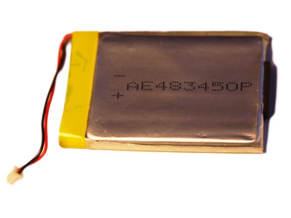

    1. Cirago M9030 Battery Replacement, Battery: crwdns2935265:017crwdnd2935265:01crwdnd2935265:02crwdne2935265:0 Cirago M9030 Battery Replacement, Battery: crwdns2935265:017crwdnd2935265:02crwdnd2935265:02crwdne2935265:0
      • Flip over the motherboard so the screen faces up.
      • Carefully slide the battery off of the motherboard.
      • Leave the battery cable connected to the motherboard.

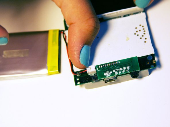

    2. Cirago M9030 Battery Replacement: crwdns2935265:018crwdnd2935265:01crwdnd2935265:03crwdne2935265:0 Cirago M9030 Battery Replacement: crwdns2935265:018crwdnd2935265:02crwdnd2935265:03crwdne2935265:0 Cirago M9030 Battery Replacement: crwdns2935265:018crwdnd2935265:03crwdnd2935265:03crwdne2935265:0
      • Place two fingers on the battery connectors and gently pull the power cable connector completely out from the motherboard.
      • Do not pull directly on the wire as it may damage the connector.
