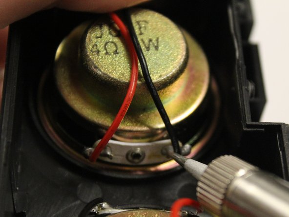

  9. Cineyo BT-03 Device Speaker Replacement: crwdns2935265:09crwdnd2935265:01crwdnd2935265:02crwdne2935265:0 Cineyo BT-03 Device Speaker Replacement: crwdns2935265:09crwdnd2935265:02crwdnd2935265:02crwdne2935265:0
    • Detach the solder points on each gold speaker in order to release and remove them.
    • For help soldering, please review iFixit's Soldering Guide.
