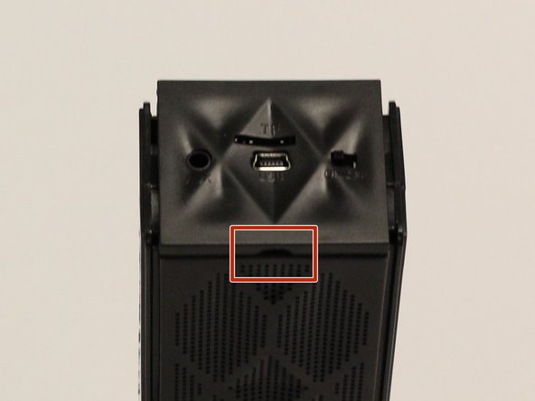

      • Remove the top (button side) rubber cover using your hands.

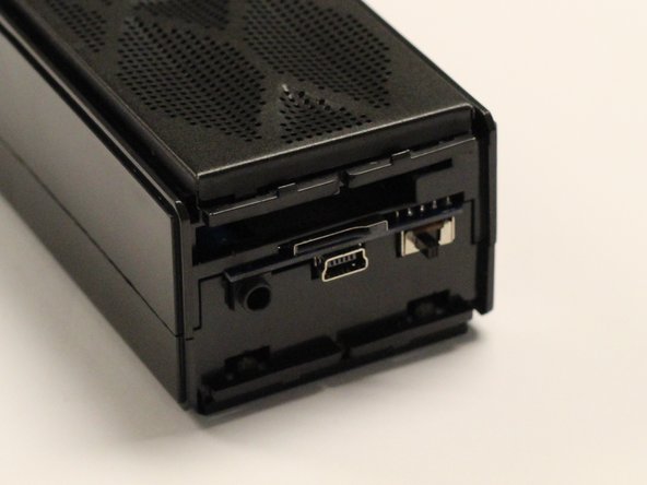

      • Flip over the device and remove the bottom rubber cover using your hands.

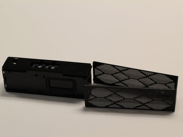

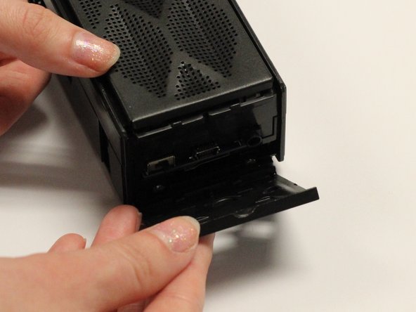

      • Using your hands, pull off the plastic side cover (on the side with the audio jack) using the indented tab. The indented tab has been highlighted in the picture.

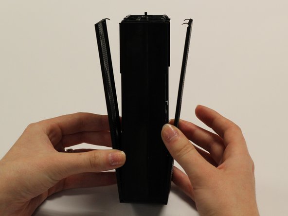

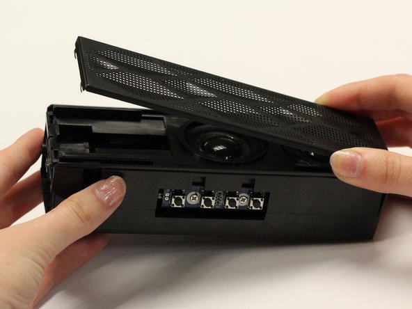

      • Detach the plastic speaker cover on both the front and back sides. Then slide the cover off of the device.
      • The cover should remain as one solid piece.

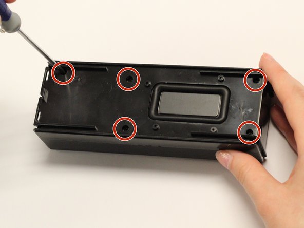

    5. Cineyo BT-03 Device Page Button Replacement: crwdns2935265:05crwdnd2935265:01crwdnd2935265:01crwdne2935265:0

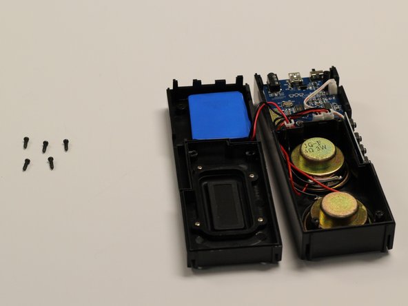

      • Remove the five 1 cm screws on the back side (opposite of the speakers) of the device using a Phillips #1 screwdriver.
    6. Cineyo BT-03 Device Page Button Replacement: crwdns2935265:06crwdnd2935265:01crwdnd2935265:01crwdne2935265:0
      • Gently pull apart the two sections of the device.

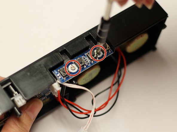

    1. Cineyo BT-03 Device Page Button Replacement, Button: crwdns2935265:07crwdnd2935265:01crwdnd2935265:02crwdne2935265:0 Cineyo BT-03 Device Page Button Replacement, Button: crwdns2935265:07crwdnd2935265:02crwdnd2935265:02crwdne2935265:0
      • With a Phillips #1 screwdriver, remove the two 5mm screws which attach the button mount to the plastic casing of the device.

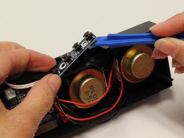

    2. Cineyo BT-03 Device Page Button Replacement: crwdns2935265:08crwdnd2935265:01crwdnd2935265:02crwdne2935265:0 Cineyo BT-03 Device Page Button Replacement: crwdns2935265:08crwdnd2935265:02crwdnd2935265:02crwdne2935265:0
      • Using a plastic opening tool, pry the button mount off of the plastic casing of the device.

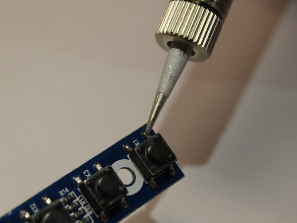

      • Using a soldering iron and iFixit’s Soldering Guide, remove the individual buttons.
