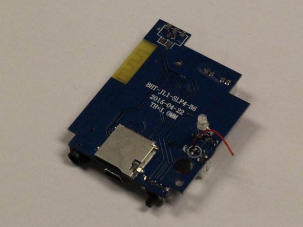

  7. Cineyo BT-03 Device Audio Jack Replacement, Audio Jack: crwdns2935265:07crwdnd2935265:01crwdnd2935265:01crwdne2935265:0
    • Disconnect all wires from the top of the circuit board.
  8. Cineyo BT-03 Device Audio Jack Replacement: crwdns2935265:08crwdnd2935265:01crwdnd2935265:01crwdne2935265:0
    • Using a small Philips head screwdriver, remove the two 5 mm screws from the main circuit board.
  9. Cineyo BT-03 Device Audio Jack Replacement: crwdns2935265:09crwdnd2935265:01crwdnd2935265:01crwdne2935265:0
    • Use the soldering iron to melt the two contact points that attach the wires to the rear side of the circuit board.
    • This will require soldering off the wires connecting the bottom of the circuit board to the device. iFixit's Soldering Guide is available to aid in soldering.
  10. Cineyo BT-03 Device Audio Jack Replacement: crwdns2935265:010crwdnd2935265:01crwdnd2935265:02crwdne2935265:0 Cineyo BT-03 Device Audio Jack Replacement: crwdns2935265:010crwdnd2935265:02crwdnd2935265:02crwdne2935265:0
    • Remove the circuit board from the device.
  11. Cineyo BT-03 Device Audio Jack Replacement: crwdns2935265:011crwdnd2935265:01crwdnd2935265:01crwdne2935265:0
    • Using a soldering iron, remove the audio jack from the circuit board.
    • There are four contact points attaching the audio jack.
