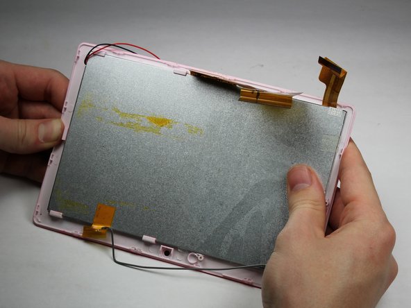

      • Insert your Plastic Opening Tool into the crease between the front panel and back panel.
      • Slide the Opening Tool around the entire device. As you progress, you should see the device open.
    2. Chromo Noria Touch Screen Replacement: crwdns2935265:02crwdnd2935265:01crwdnd2935265:01crwdne2935265:0
      • Carefully turn the device over.
      • Lay the back panel aside so you can see the device's parts.

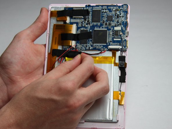

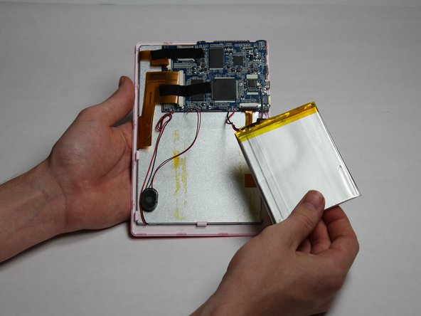

    1. Chromo Noria Touch Screen Replacement, Battery: crwdns2935265:03crwdnd2935265:01crwdnd2935265:03crwdne2935265:0 Chromo Noria Touch Screen Replacement, Battery: crwdns2935265:03crwdnd2935265:02crwdnd2935265:03crwdne2935265:0 Chromo Noria Touch Screen Replacement, Battery: crwdns2935265:03crwdnd2935265:03crwdnd2935265:03crwdne2935265:0
      • Place your finger at the end of the tape closest to the battery.
      • Peel the tape towards the flex cables to free the battery wires.

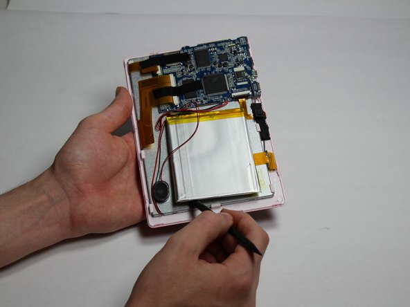

    2. Chromo Noria Touch Screen Replacement: crwdns2935265:04crwdnd2935265:01crwdnd2935265:03crwdne2935265:0 Chromo Noria Touch Screen Replacement: crwdns2935265:04crwdnd2935265:02crwdnd2935265:03crwdne2935265:0 Chromo Noria Touch Screen Replacement: crwdns2935265:04crwdnd2935265:03crwdnd2935265:03crwdne2935265:0
      • Using the spudger tool, place the tool along an edge of the battery.
      • Be careful not to bend or break the battery! Batteries contain hazards materials.
      • Move the spudger around the edges of the battery to detach it from the tablet.
    3. Chromo Noria Touch Screen Replacement: crwdns2935265:05crwdnd2935265:01crwdnd2935265:01crwdne2935265:0
      • Soldering irons get very hot! Be careful when handling one. If you'd like a tutorial on how to use one, click here.
      • Using a soldering iron, desolder both of the battery wires. The battery's wires are located to the left of the camera's flex cable.
      • Remove the battery.

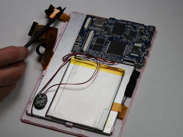

    1. Chromo Noria Touch Screen Replacement, Speaker: crwdns2935265:09crwdnd2935265:01crwdnd2935265:01crwdne2935265:0
      • Using your spudger tool, remove speaker from the backboard.
    2. Chromo Noria Touch Screen Replacement: crwdns2935265:010crwdnd2935265:01crwdnd2935265:02crwdne2935265:0 Chromo Noria Touch Screen Replacement: crwdns2935265:010crwdnd2935265:02crwdnd2935265:02crwdne2935265:0
      • Using the spudger tool, detach the speaker from the back of the screen.

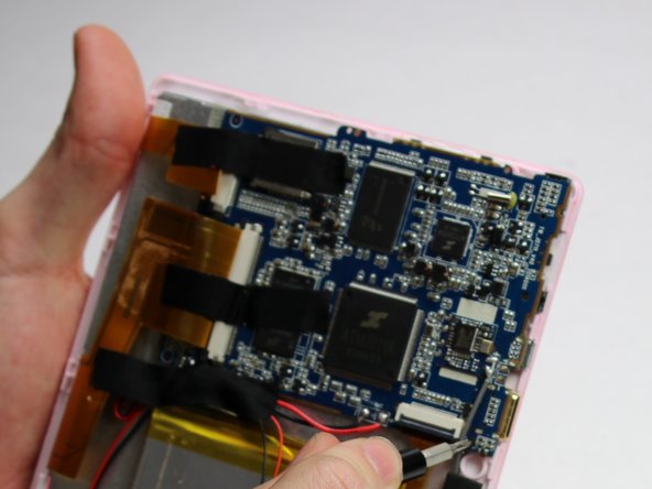

    1. Chromo Noria Touch Screen Replacement, Motherboard: crwdns2935265:012crwdnd2935265:01crwdnd2935265:02crwdne2935265:0 Chromo Noria Touch Screen Replacement, Motherboard: crwdns2935265:012crwdnd2935265:02crwdnd2935265:02crwdne2935265:0
      • Using a Phillips #00 Precision Screwdriver, remove the three 3mm screws by turning the screwdriver counter-clockwise.
    2. Chromo Noria Touch Screen Replacement: crwdns2935265:013crwdnd2935265:01crwdnd2935265:01crwdne2935265:0
      • Remove the three pieces of tap keeping the wires in place.

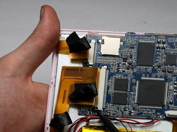

    3. Chromo Noria Touch Screen Replacement: crwdns2935265:014crwdnd2935265:01crwdnd2935265:03crwdne2935265:0 Chromo Noria Touch Screen Replacement: crwdns2935265:014crwdnd2935265:02crwdnd2935265:03crwdne2935265:0 Chromo Noria Touch Screen Replacement: crwdns2935265:014crwdnd2935265:03crwdnd2935265:03crwdne2935265:0
      • Place a spudger on the small black pins on either side of the flex cables.
      • Gently push the spudger towards the back of flex cables to unlock the flex cable.
      • Remove the flex cables from their insert.
    4. Chromo Noria Touch Screen Replacement: crwdns2935265:015crwdnd2935265:01crwdnd2935265:01crwdne2935265:0
      • Desolder the eight connections.
    5. Chromo Noria Touch Screen Replacement: crwdns2935265:016crwdnd2935265:01crwdnd2935265:01crwdne2935265:0
      • Lift the motherboard to remove.

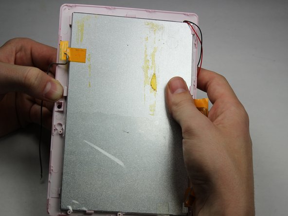

    1. Chromo Noria Touch Screen Replacement, Touch Screen: crwdns2935265:017crwdnd2935265:01crwdnd2935265:03crwdne2935265:0 Chromo Noria Touch Screen Replacement, Touch Screen: crwdns2935265:017crwdnd2935265:02crwdnd2935265:03crwdne2935265:0 Chromo Noria Touch Screen Replacement, Touch Screen: crwdns2935265:017crwdnd2935265:03crwdnd2935265:03crwdne2935265:0
      • Apply downward pressure to each of the clips that hold the touchscreen to the plastic surround.
      • Careful to not apply so much pressure as to break the device! These hinges should move easily.
      • Work your way around the device in a clockwise motion as you progress.
