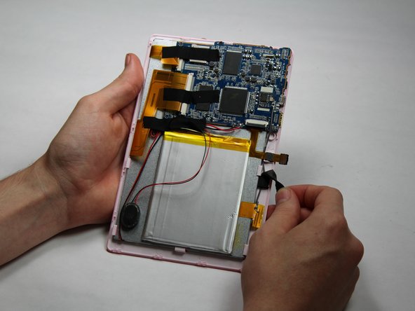

      • Insert your Plastic Opening Tool into the crease between the front panel and back panel.
      • Slide the Opening Tool around the entire device. As you progress, you should see the device open.
    2. Chromo Noria Camera  Replacement: crwdns2935265:02crwdnd2935265:01crwdnd2935265:01crwdne2935265:0
      • Carefully turn the device over.
      • Lay the back panel aside so you can see the device's parts.

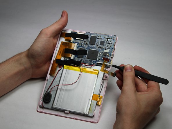

    1. Chromo Noria Camera  Replacement, Camera: crwdns2935265:03crwdnd2935265:01crwdnd2935265:02crwdne2935265:0 Chromo Noria Camera  Replacement, Camera: crwdns2935265:03crwdnd2935265:02crwdnd2935265:02crwdne2935265:0
      • Carefully detach one side of the black tape from the board.
    2. Chromo Noria Camera  Replacement: crwdns2935265:04crwdnd2935265:01crwdnd2935265:02crwdne2935265:0 Chromo Noria Camera  Replacement: crwdns2935265:04crwdnd2935265:02crwdnd2935265:02crwdne2935265:0
      • Using a small plastic opening tool, flip the black connector up until it makes "tick" sound.
      • Now, the flexing cable is ready to be removed.

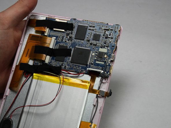

    3. Chromo Noria Camera  Replacement: crwdns2935265:05crwdnd2935265:01crwdnd2935265:02crwdne2935265:0 Chromo Noria Camera  Replacement: crwdns2935265:05crwdnd2935265:02crwdnd2935265:02crwdne2935265:0
      • Using a pair of tweezers, hold the flexing cable right below the black connector.
      • Gently pull the flexing cable out of the connector while balancing the other side of the device with another hand.
