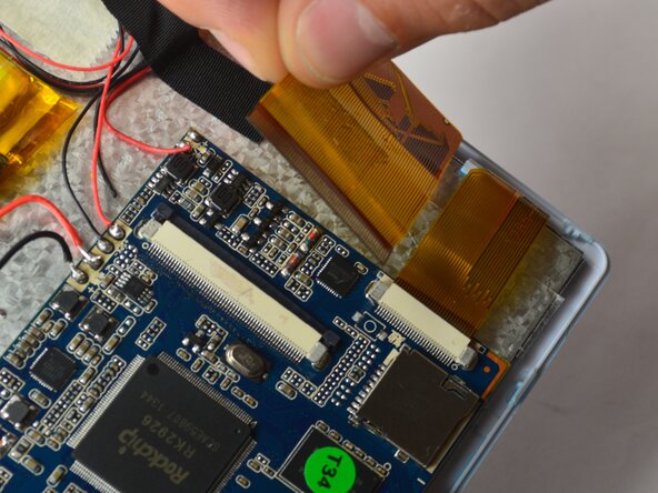

  3. Chromo Inc. T2 Motherboard Replacement, Disconnecting Flex Cables: crwdns2935265:03crwdnd2935265:01crwdnd2935265:02crwdne2935265:0 Chromo Inc. T2 Motherboard Replacement, Disconnecting Flex Cables: crwdns2935265:03crwdnd2935265:02crwdnd2935265:02crwdne2935265:0
    • Peel back the tape holding the big flex cable in place.
    • Using your plastic opening tool, gently push back the gray connector to free the flex cables and then pull them out.

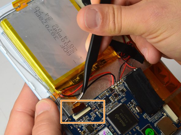

  4. Chromo Inc. T2 Motherboard Replacement, Disconnecting the Camera: crwdns2935265:04crwdnd2935265:01crwdnd2935265:02crwdne2935265:0 Chromo Inc. T2 Motherboard Replacement, Disconnecting the Camera: crwdns2935265:04crwdnd2935265:02crwdnd2935265:02crwdne2935265:0
    • Using the small plastic opening tool, gently push the gray connector back to unlock the flex cable.
    • Using a pair of tweezers, gently grasp the flex cable and disconnect it from the connector.

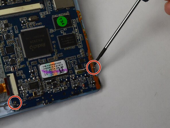

  5. Chromo Inc. T2 Motherboard Replacement: crwdns2935265:05crwdnd2935265:01crwdnd2935265:02crwdne2935265:0 Chromo Inc. T2 Motherboard Replacement: crwdns2935265:05crwdnd2935265:02crwdnd2935265:02crwdne2935265:0
    • Using a Phillips #00 Precision Screwdriver, remove the three 3mm screws holding the motherboard.

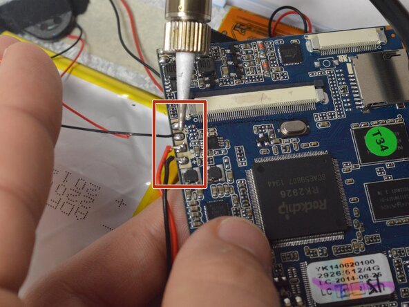

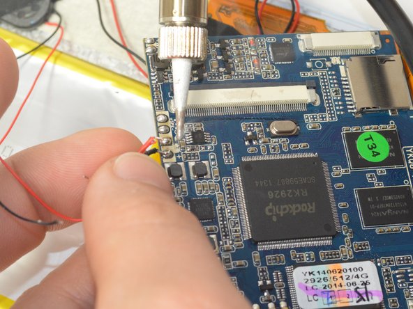

  6. Chromo Inc. T2 Motherboard Replacement: crwdns2935265:06crwdnd2935265:01crwdnd2935265:03crwdne2935265:0 Chromo Inc. T2 Motherboard Replacement: crwdns2935265:06crwdnd2935265:02crwdnd2935265:03crwdne2935265:0 Chromo Inc. T2 Motherboard Replacement: crwdns2935265:06crwdnd2935265:03crwdnd2935265:03crwdne2935265:0
    • Using your soldering iron, desolder the six wires on the side of the logic board.
    • Remember where these wires go as re-connecting them incorrectly can lead to damaging the device!
    • Soldering Iron gets very hot, take care to not touch anywhere on the soldering iron except for the handle!

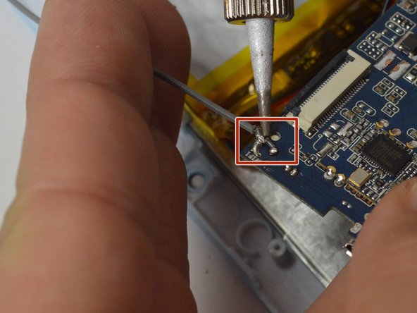

  7. Chromo Inc. T2 Motherboard Replacement: crwdns2935265:07crwdnd2935265:01crwdnd2935265:02crwdne2935265:0 Chromo Inc. T2 Motherboard Replacement: crwdns2935265:07crwdnd2935265:02crwdnd2935265:02crwdne2935265:0
    • Using your soldering Iron, desolder the grounding cable on the motherboard.
