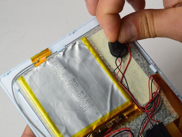

  3. Chromo Inc. T2 Internal Speaker Replacement, Removing the Tape: crwdns2935265:03crwdnd2935265:01crwdnd2935265:03crwdne2935265:0 Chromo Inc. T2 Internal Speaker Replacement, Removing the Tape: crwdns2935265:03crwdnd2935265:02crwdnd2935265:03crwdne2935265:0 Chromo Inc. T2 Internal Speaker Replacement, Removing the Tape: crwdns2935265:03crwdnd2935265:03crwdnd2935265:03crwdne2935265:0
    • Remove the two strips of tape.
    • One piece of tape is holding down the wires and the other is holding down the speaker.

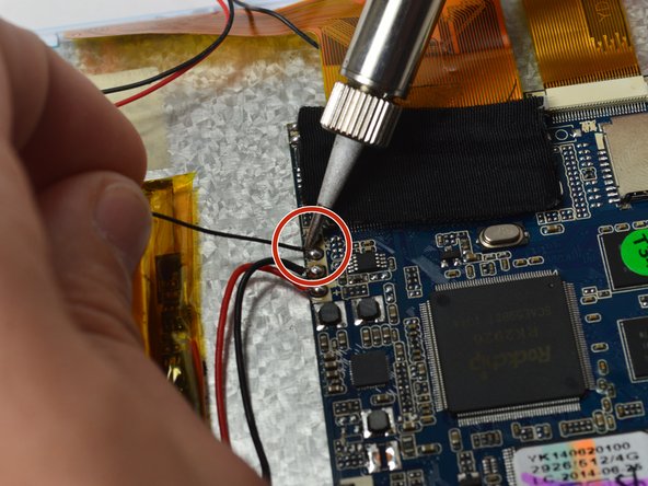

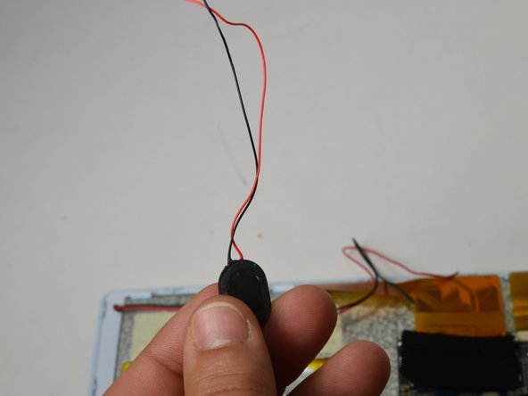

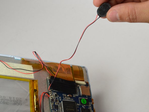

  4. Chromo Inc. T2 Internal Speaker Replacement, Desoldering the Wires and Removing the Speaker: crwdns2935265:04crwdnd2935265:01crwdnd2935265:03crwdne2935265:0 Chromo Inc. T2 Internal Speaker Replacement, Desoldering the Wires and Removing the Speaker: crwdns2935265:04crwdnd2935265:02crwdnd2935265:03crwdne2935265:0 Chromo Inc. T2 Internal Speaker Replacement, Desoldering the Wires and Removing the Speaker: crwdns2935265:04crwdnd2935265:03crwdnd2935265:03crwdne2935265:0
    • A soldering iron gets very hot. Do not touch anywhere on the soldering iron except for the handle!
    • Using a soldering iron, desolder both speaker wires (one red wire and one black wire).
    • Now that the wires are desoldered, the internal speaker is ready for replacement.
