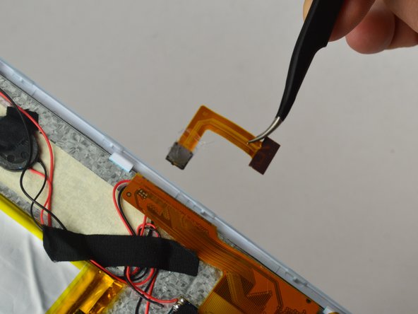

    • Place your plastic opening tool between the screen and the case. Slowly move it around the casing while prying in a downward motion to undo the hinges holding the two together and separate the two parts.
  2. Chromo Inc. T2 Front Facing Camera Replacement, Turn it around: crwdns2935265:02crwdnd2935265:01crwdnd2935265:01crwdne2935265:0
    • After separating the case and screen, turn your screen face down so you can see the internal parts!
  3. Chromo Inc. T2 Front Facing Camera Replacement, Getting to the camera: crwdns2935265:03crwdnd2935265:01crwdnd2935265:01crwdne2935265:0
    • Remove the tape that holds the camera in place.
  4. Chromo Inc. T2 Front Facing Camera Replacement, Free up the flex cable: crwdns2935265:04crwdnd2935265:01crwdnd2935265:01crwdne2935265:0
    • Using the small plastic opening tool, gently push the gray connector back to unlock the flex cable.
  5. Chromo Inc. T2 Front Facing Camera Replacement, Removing the Flex Cable and Camera: crwdns2935265:05crwdnd2935265:01crwdnd2935265:02crwdne2935265:0 Chromo Inc. T2 Front Facing Camera Replacement, Removing the Flex Cable and Camera: crwdns2935265:05crwdnd2935265:02crwdnd2935265:02crwdne2935265:0
    • Using a pair of tweezers, gently grasp the flex cable and pull it out while using your other hand to keep the camera in place. Once removed, your camera is now free and ready for replacement!
Now that your camera is removed from the rest of the internal parts, it can be replaced!
