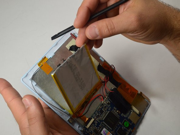

  3. Chromo Inc. T2 Battery Replacement, Freeing the Battery: crwdns2935265:03crwdnd2935265:01crwdnd2935265:03crwdne2935265:0 Chromo Inc. T2 Battery Replacement, Freeing the Battery: crwdns2935265:03crwdnd2935265:02crwdnd2935265:03crwdne2935265:0 Chromo Inc. T2 Battery Replacement, Freeing the Battery: crwdns2935265:03crwdnd2935265:03crwdnd2935265:03crwdne2935265:0
    • Using the Spudger, going between the battery and screen, pry the battery off from the tablet.
    • Note: This will require a little extra force due to the tape holding down the battery!
  4. Chromo Inc. T2 Battery Replacement, Desoldering the Battery Wires: crwdns2935265:04crwdnd2935265:01crwdnd2935265:01crwdne2935265:0
    • Using a Soldering Iron, desolder both Battery wires.
    • Soldering Iron gets very hot, take care to not touch anywhere on the soldering iron except for the handle!
