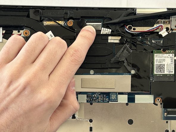

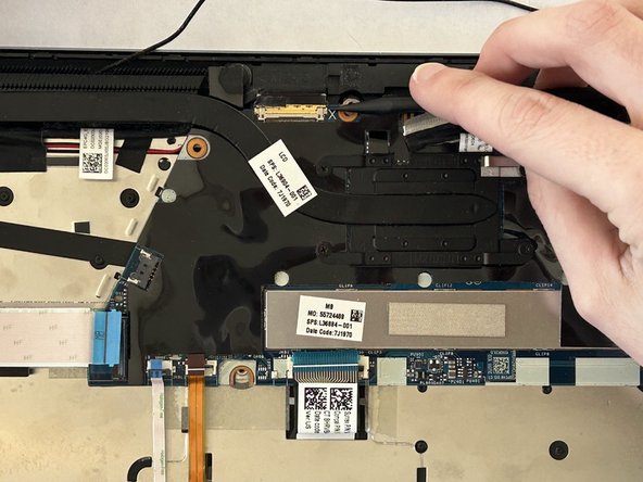

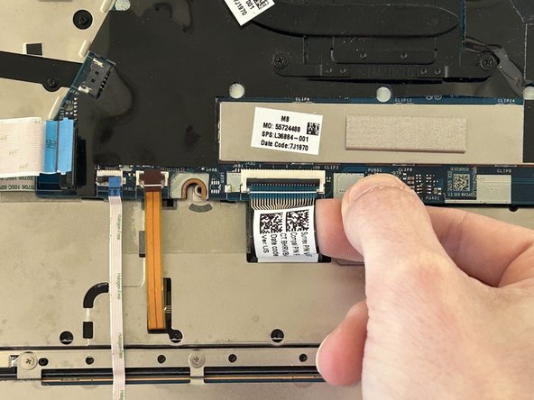

  9. Chromebook x360 14-da0011dx Motherboard Replacement, Motherboard: crwdns2935265:09crwdnd2935265:01crwdnd2935265:03crwdne2935265:0 Chromebook x360 14-da0011dx Motherboard Replacement, Motherboard: crwdns2935265:09crwdnd2935265:02crwdnd2935265:03crwdne2935265:0 Chromebook x360 14-da0011dx Motherboard Replacement, Motherboard: crwdns2935265:09crwdnd2935265:03crwdnd2935265:03crwdne2935265:0
    • Lift the ZIF connector locking flaps, then remove the ribbon cables.
    • There are several small connections for the ribbon cables. Exercise extreme caution when disconnecting the cables.
    • One ribbon cable is on the underside of the motherboard and will be removed later.

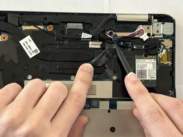

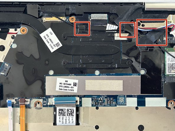

  11. Chromebook x360 14-da0011dx Motherboard Replacement: crwdns2935265:011crwdnd2935265:01crwdnd2935265:03crwdne2935265:0 Chromebook x360 14-da0011dx Motherboard Replacement: crwdns2935265:011crwdnd2935265:02crwdnd2935265:03crwdne2935265:0 Chromebook x360 14-da0011dx Motherboard Replacement: crwdns2935265:011crwdnd2935265:03crwdnd2935265:03crwdne2935265:0
    • Disconnect the cables attached to the Wi-Fi card and motherboard along the top edge.
    • The leftmost connector is a ribbon-style connector with a metal locking bar that must be unlatched.
  12. Chromebook x360 14-da0011dx Motherboard Replacement: crwdns2935265:012crwdnd2935265:01crwdnd2935265:03crwdne2935265:0 Chromebook x360 14-da0011dx Motherboard Replacement: crwdns2935265:012crwdnd2935265:02crwdnd2935265:03crwdne2935265:0 Chromebook x360 14-da0011dx Motherboard Replacement: crwdns2935265:012crwdnd2935265:03crwdnd2935265:03crwdne2935265:0
    • Use a spudger to remove the tape and plastic shielding that secure the wires.

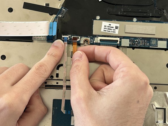

  13. Chromebook x360 14-da0011dx Motherboard Replacement: crwdns2935265:013crwdnd2935265:01crwdnd2935265:01crwdne2935265:0
    • Gently lift the motherboard until it is loose.
    • Disconnect the ribbon cable attached to the underside of the motherboard.
    • The locking flap on this ribbon cable must be flipped down to unlock.
