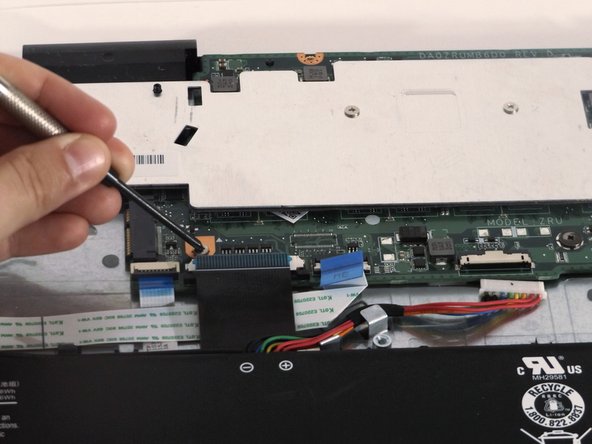

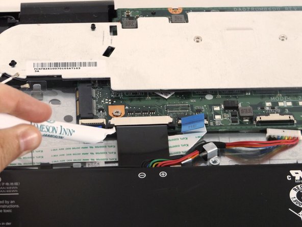

  10. Chromebook 15 CB3-531-C4A5 Motherboard Replacement: crwdns2935265:010crwdnd2935265:01crwdnd2935265:03crwdne2935265:0 Chromebook 15 CB3-531-C4A5 Motherboard Replacement: crwdns2935265:010crwdnd2935265:02crwdnd2935265:03crwdne2935265:0 Chromebook 15 CB3-531-C4A5 Motherboard Replacement: crwdns2935265:010crwdnd2935265:03crwdnd2935265:03crwdne2935265:0
    • Remove tape that secures the ribbon cables.
    • Using the spudger, lift the latches to unlock each ribbon cable.
    • Remove the cables.

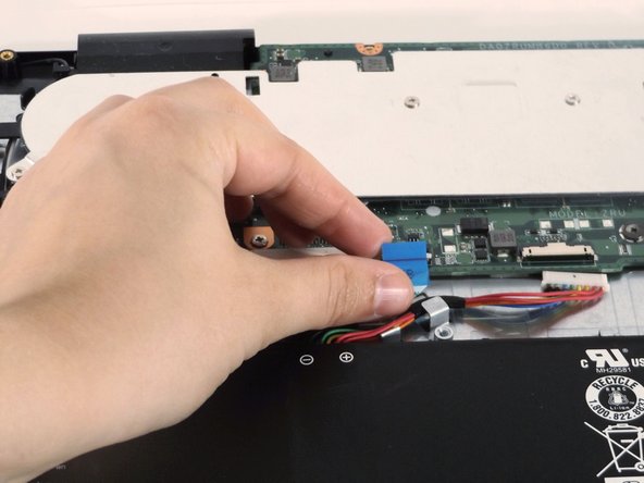

  11. Chromebook 15 CB3-531-C4A5 Motherboard Replacement: crwdns2935265:011crwdnd2935265:01crwdnd2935265:01crwdne2935265:0
    • Remove the large black cable between the two ribbon cables.
  12. Chromebook 15 CB3-531-C4A5 Motherboard Replacement: crwdns2935265:012crwdnd2935265:01crwdnd2935265:01crwdne2935265:0
    • Remove the remaining cable.
    • Remove the motherboard.
