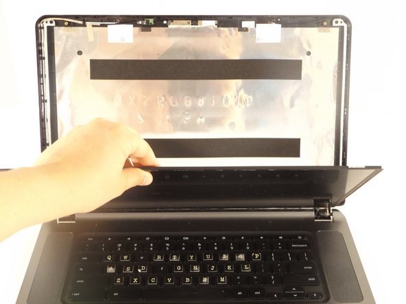

    • Remove the bezel with a plastic spudger.
  2. Chromebook 15 CB3-531-C4A5  Screen Replacement: crwdns2935265:02crwdnd2935265:01crwdnd2935265:02crwdne2935265:0 Chromebook 15 CB3-531-C4A5  Screen Replacement: crwdns2935265:02crwdnd2935265:02crwdnd2935265:02crwdne2935265:0
    • Remove four screws - one in each corner along the screen.
  3. Chromebook 15 CB3-531-C4A5  Screen Replacement: crwdns2935265:03crwdnd2935265:01crwdnd2935265:02crwdne2935265:0 Chromebook 15 CB3-531-C4A5  Screen Replacement: crwdns2935265:03crwdnd2935265:02crwdnd2935265:02crwdne2935265:0
    • Remove Screen by gently pulling it out and then lifting it up.

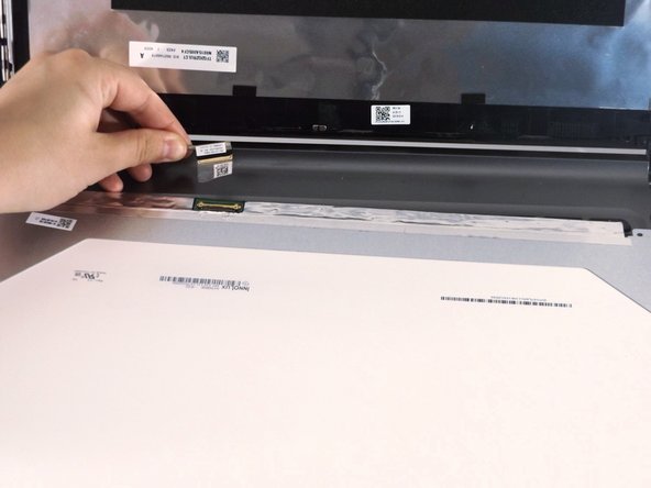

  4. Chromebook 15 CB3-531-C4A5  Screen Replacement: crwdns2935265:04crwdnd2935265:01crwdnd2935265:02crwdne2935265:0 Chromebook 15 CB3-531-C4A5  Screen Replacement: crwdns2935265:04crwdnd2935265:02crwdnd2935265:02crwdne2935265:0
    • Remove the LCD data cable which will allow the screen to be removed completely.
