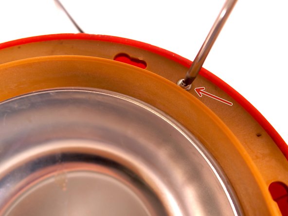

    • Unscrew the 4 screws around the exposed orange rim with a Phillips #1 screwdriver.

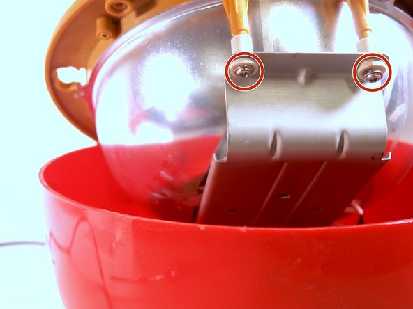

  4. Chocomaker Apple Dipper 9820 Disassembly: crwdns2935265:04crwdnd2935265:01crwdnd2935265:02crwdne2935265:0 Chocomaker Apple Dipper 9820 Disassembly: crwdns2935265:04crwdnd2935265:02crwdnd2935265:02crwdne2935265:0
    • Lift the white bowl and metal bowl (with orange rim) as far as they go, in order to access and unscrew two screws from the metal part.
    • Unscrew using the Phillips #1 screwdriver.
    • These screws have a white circumference and are attached to the metal.

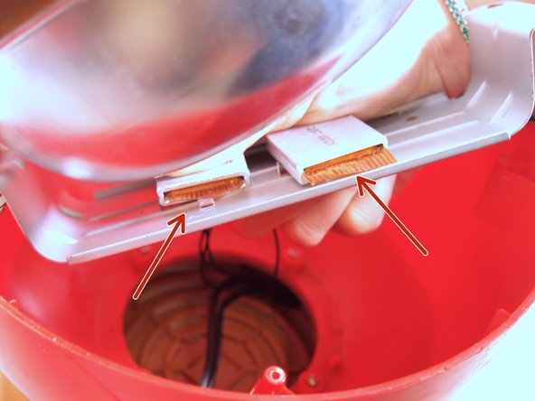

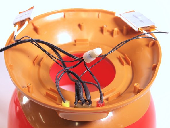

  5. Chocomaker Apple Dipper 9820 Disassembly: crwdns2935265:05crwdnd2935265:01crwdnd2935265:02crwdne2935265:0 Chocomaker Apple Dipper 9820 Disassembly: crwdns2935265:05crwdnd2935265:02crwdnd2935265:02crwdne2935265:0
    • Remove the heat plates from under the metal plate holding them down.
    • This will allow you to completely remove the white bowl and metal bowl with the orange rim, leaving you with the red outer bowl and partially exposed circuit.

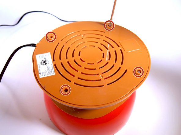

    • Flip the apple.
    • Remove the bottom lid by using the Phillips #1 screwdriver to remove the four screws.

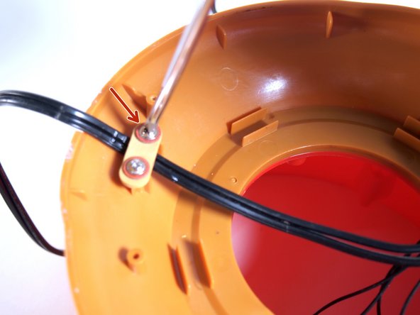

  7. Chocomaker Apple Dipper 9820 Disassembly: crwdns2935265:07crwdnd2935265:01crwdnd2935265:03crwdne2935265:0 Chocomaker Apple Dipper 9820 Disassembly: crwdns2935265:07crwdnd2935265:02crwdnd2935265:03crwdne2935265:0 Chocomaker Apple Dipper 9820 Disassembly: crwdns2935265:07crwdnd2935265:03crwdnd2935265:03crwdne2935265:0
    • Remove the 2 mm screws from the wire holder with a P106A screwdriver.
    • These screws are only holding the wire for it to come out of the apple in the right way. (They are two screws attached to a small orange thing)

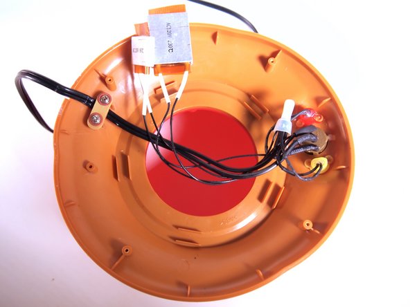

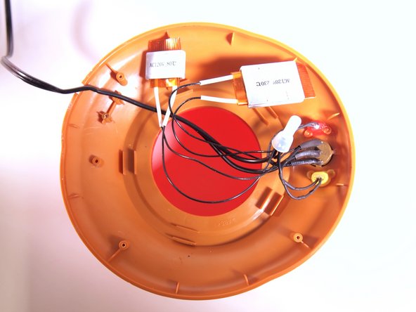

  8. Chocomaker Apple Dipper 9820 Disassembly: crwdns2935265:08crwdnd2935265:01crwdnd2935265:02crwdne2935265:0 Chocomaker Apple Dipper 9820 Disassembly: crwdns2935265:08crwdnd2935265:02crwdnd2935265:02crwdne2935265:0
    • Circuitry is exposed.
    • This device is controlled by a switch which influences where voltage and current occurs within the circuit.
    • There is one are two loops: one accounts for the "warm" setting and the other accounts for the "melt" setting.
