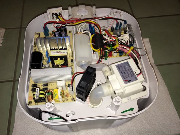

  8. ChiliTechnology ChiliCube Teardown, 1st  look  bottom of ChiliCube: crwdns2935265:08crwdnd2935265:01crwdnd2935265:03crwdne2935265:0 ChiliTechnology ChiliCube Teardown, 1st  look  bottom of ChiliCube: crwdns2935265:08crwdnd2935265:02crwdnd2935265:03crwdne2935265:0 ChiliTechnology ChiliCube Teardown, 1st  look  bottom of ChiliCube: crwdns2935265:08crwdnd2935265:03crwdnd2935265:03crwdne2935265:0
    • Underneath, where most of the electronics are located. This hangs upside down during normal use.
    • Note that there is actually a third fan in every unit to cool the power supply (and pump?). Luckily this fan is quieter.
  9. ChiliTechnology ChiliCube Teardown, 2nd look at bottom of ChiliCube: crwdns2935265:09crwdnd2935265:01crwdnd2935265:03crwdne2935265:0 ChiliTechnology ChiliCube Teardown, 2nd look at bottom of ChiliCube: crwdns2935265:09crwdnd2935265:02crwdnd2935265:03crwdne2935265:0 ChiliTechnology ChiliCube Teardown, 2nd look at bottom of ChiliCube: crwdns2935265:09crwdnd2935265:03crwdnd2935265:03crwdne2935265:0
    • Your author's cubes both had this thin red cable floating with one end loose. This is the antenna for the wireless control. (Radio as opposed to infrared like your TV wireless control, because you may not have good line-of-sight.)
    • Water pump, and small fan.
    • Power supply.

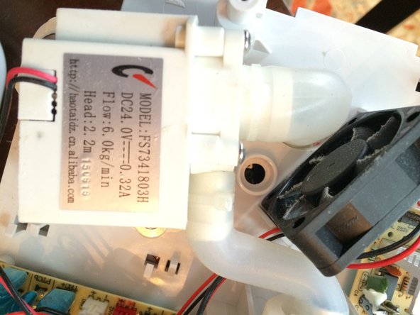

  12. ChiliTechnology ChiliCube Teardown, Detach pump: crwdns2935265:012crwdnd2935265:01crwdnd2935265:03crwdne2935265:0 ChiliTechnology ChiliCube Teardown, Detach pump: crwdns2935265:012crwdnd2935265:02crwdnd2935265:03crwdne2935265:0 ChiliTechnology ChiliCube Teardown, Detach pump: crwdns2935265:012crwdnd2935265:03crwdnd2935265:03crwdne2935265:0
    • Unwilling to disconnect the pump, your author instead has just demonstrated what would be removed next. You must remove 3 screws anchoring the pump.
    • There is a bit of play with the silicone tubes connecting the pump to the resevoir once the deck is disconnected
    • The pump has got some stand-offs and silicone grommets to isolate vibrations from the rest of the cube to keep things quiet.

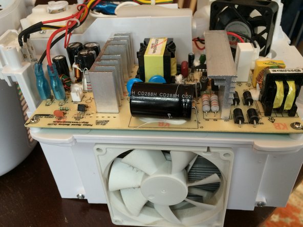

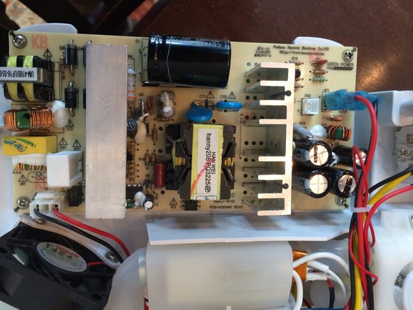

  13. ChiliTechnology ChiliCube Teardown, Detach circuit boards: crwdns2935265:013crwdnd2935265:01crwdnd2935265:03crwdne2935265:0 ChiliTechnology ChiliCube Teardown, Detach circuit boards: crwdns2935265:013crwdnd2935265:02crwdnd2935265:03crwdne2935265:0 ChiliTechnology ChiliCube Teardown, Detach circuit boards: crwdns2935265:013crwdnd2935265:03crwdnd2935265:03crwdne2935265:0
    • Remove 4 screws apiece from the main circuit board, and the circuit board for the power supply.
    • Once the pump and those boards are removed, you can access the 4 screws attaching the deck to the heat sinks and reservoir.

where can i gey replacement pump ? Thanks,Art
art838 - crwdns2934203:0crwdne2934203:0
where can i get replacement pump ? Thanks,Art
I haven't needed to replace my pump, so I do not have that info. I would 1st suggest contacting Chili, but according to an Amazon reviewer for the previous version of their cube, they were completely unhelpful.
Based on the markings on the pump in my photos, I came up with the following requirements to find a pump:
o 0.24 Amps at 24 V DC, which means it should not consume much more than 10 watts 24 DC
o 6 Liters/Minute, which is 1.5 Gallons/minute, 360 Liters/hour, or 95 Gallons/hour (GPH). I think that measurement is taken with a head of 2.2Meters or 7.2 feet (head means the vertical distance water is moved)
o A centrifugal pump which has mounting pads and can be rigged like ours. You will have to disassemble the pump I found and rotate the inlet/outlet cap 90 degrees. I hope it goes in right direction...
This from amazon may work:
http://a.co/392FAtj
Reply & let us know what happened (I'll write it up if you want), tell us if that part worked!
