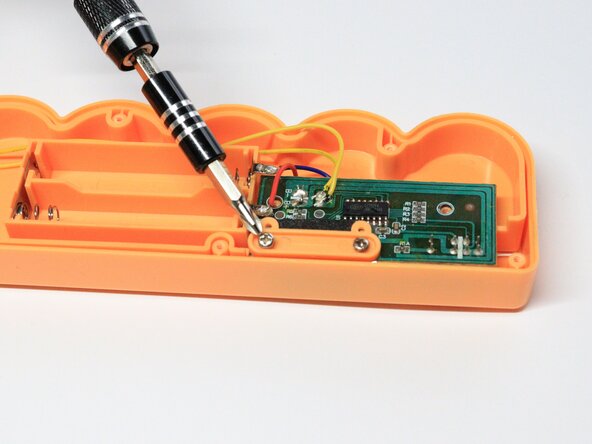

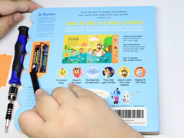

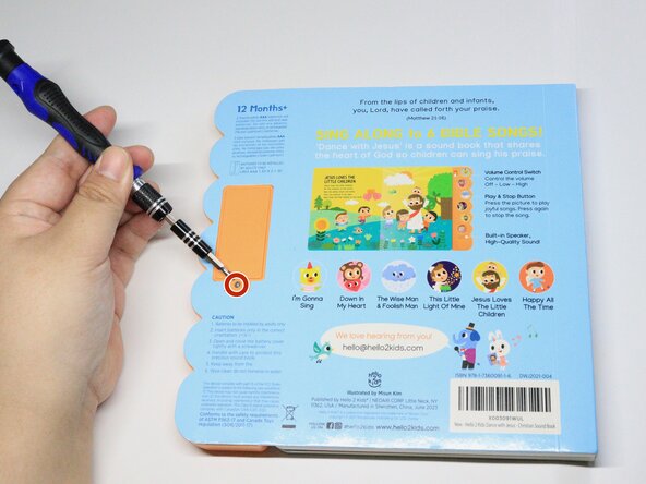

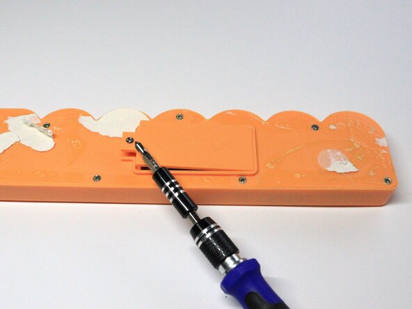

    • Remove the Phillips screw that secures the battery compartment cover.
    • Use a spudger to remove the batteries.

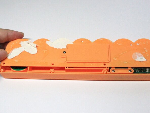

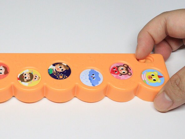

  2. Children’s Soundbook Speaker Replacement: crwdns2935265:02crwdnd2935265:01crwdnd2935265:03crwdne2935265:0 Children’s Soundbook Speaker Replacement: crwdns2935265:02crwdnd2935265:02crwdnd2935265:03crwdne2935265:0 Children’s Soundbook Speaker Replacement: crwdns2935265:02crwdnd2935265:03crwdnd2935265:03crwdne2935265:0
    • Gently remove the plastic speaker cover with a spudger.

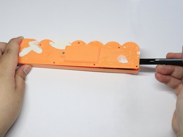

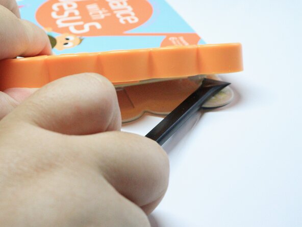

  3. Children’s Soundbook Speaker Replacement: crwdns2935265:03crwdnd2935265:01crwdnd2935265:03crwdne2935265:0 Children’s Soundbook Speaker Replacement: crwdns2935265:03crwdnd2935265:02crwdnd2935265:03crwdne2935265:0 Children’s Soundbook Speaker Replacement: crwdns2935265:03crwdnd2935265:03crwdnd2935265:03crwdne2935265:0

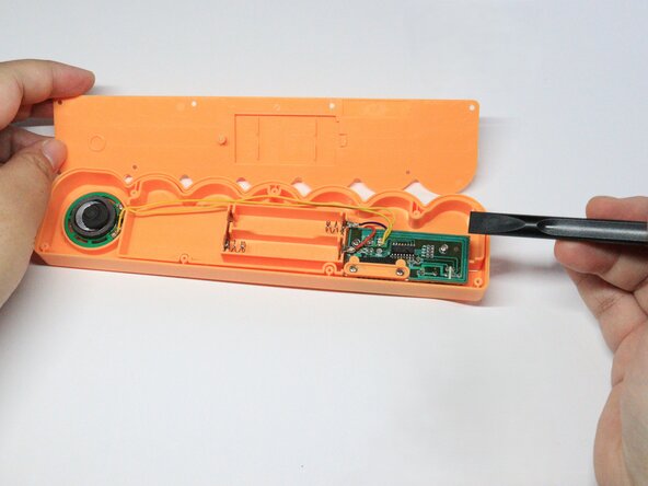

    • Remove the seven Phillips screws at the back of the speaker cover.
    • Use a pry tool to open the speaker cover.

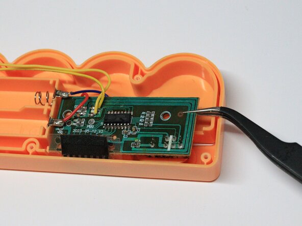

  4. Children’s Soundbook Speaker Replacement: crwdns2935265:04crwdnd2935265:01crwdnd2935265:03crwdne2935265:0 Children’s Soundbook Speaker Replacement: crwdns2935265:04crwdnd2935265:02crwdnd2935265:03crwdne2935265:0 Children’s Soundbook Speaker Replacement: crwdns2935265:04crwdnd2935265:03crwdnd2935265:03crwdne2935265:0
    • Remove the Phillips screws that secure the mainboard.
    • Your soundbook screws may use different head types.
    • Use tweezers to remove the orange magnetic cover and gently lift out the mainboard. Take care not to strain the connected wires.

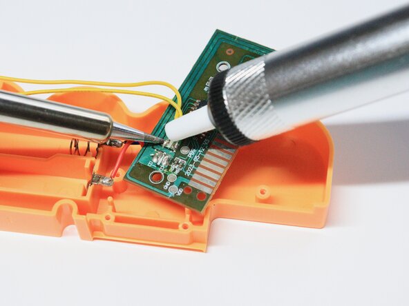

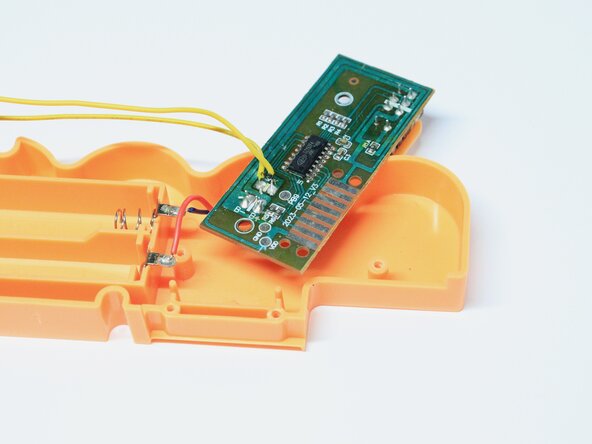

  5. Children’s Soundbook Speaker Replacement: crwdns2935265:05crwdnd2935265:01crwdnd2935265:02crwdne2935265:0 Children’s Soundbook Speaker Replacement: crwdns2935265:05crwdnd2935265:02crwdnd2935265:02crwdne2935265:0
    • Desolder the two speaker mainboard connections (two yellow wires) with a desoldering pump.
    • To allow easier suction of the metal, heat them for a few seconds using a soldering iron first at 350°C. Always solder in a well-ventilated area or with a running fume extractor.

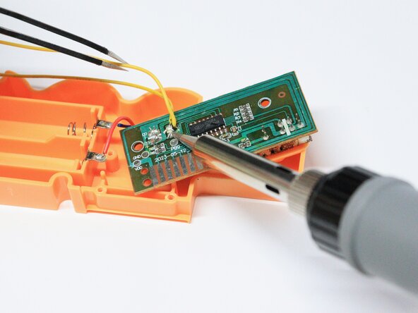

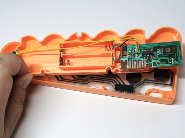

  6. Children’s Soundbook Speaker Replacement: crwdns2935265:06crwdnd2935265:01crwdnd2935265:03crwdne2935265:0 Children’s Soundbook Speaker Replacement: crwdns2935265:06crwdnd2935265:02crwdnd2935265:03crwdne2935265:0 Children’s Soundbook Speaker Replacement: crwdns2935265:06crwdnd2935265:03crwdnd2935265:03crwdne2935265:0
    • Using a soldering iron, solder the yellow wires of the new speaker to the mainboard.
    • Make sure that the soldering iron is set to 350°C.

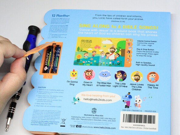

    • Replace the batteries and battery cover.
    • Fasten single Phillips screw that secures the battery cover.
    • Turn on the sound using the power button found in front of the sound case.
    • Try pressing the sound case buttons to check if sounds can be heard.

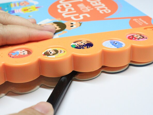

  9. Children’s Soundbook Speaker Replacement: crwdns2935265:09crwdnd2935265:01crwdnd2935265:02crwdne2935265:0 Children’s Soundbook Speaker Replacement: crwdns2935265:09crwdnd2935265:02crwdnd2935265:02crwdne2935265:0
    • Using a hot glue gun to reattach the sound case to the book and press it for a few seconds.
Now your little one can play with their soundbook again!
