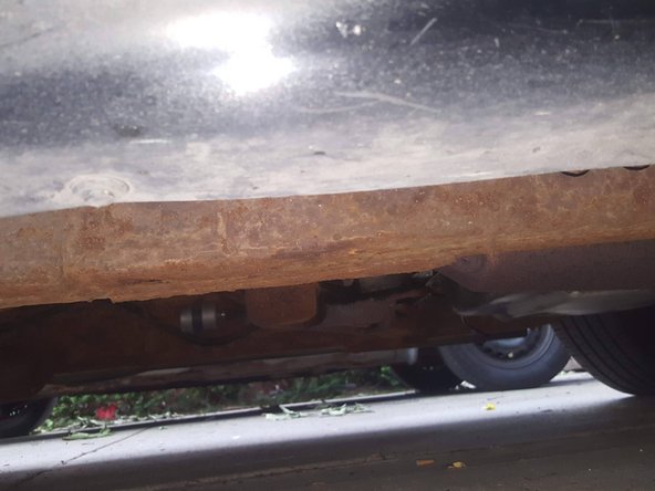

    • There are two metal bars across the passenger and driver side to lift the car with a jack.
    • Make sure to have a tire or scissor lift gate under vehicle to not fall under while working
    • Have something block back tires from moving.

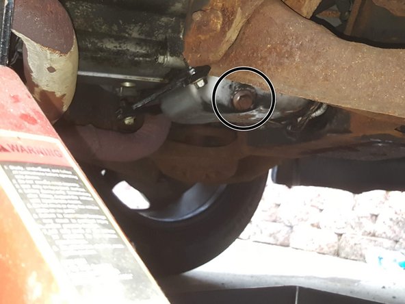

  2. Chevy s10 extreme pickup truck 1999, Remove old oil: crwdns2935265:02crwdnd2935265:01crwdnd2935265:01crwdne2935265:0
    • Its a 16 mm nut
    • After all oil has drain reinsert the 16mm nut back and clean around it.
    • Have a bucket or container to collect the oil.

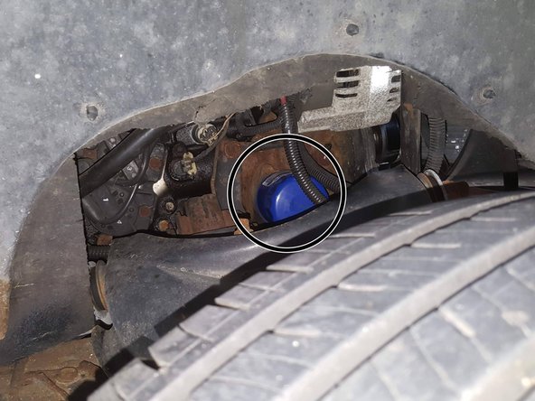

  3. Chevy s10 extreme pickup truck 1999, change the oil filter: crwdns2935265:03crwdnd2935265:01crwdnd2935265:01crwdne2935265:0
    • The filter can be seen from the tire.
    • Apply the new filter with a dab of oil around the top for lubrication.
    • If filter is hard to get loose consider buying a oil filter wrench.

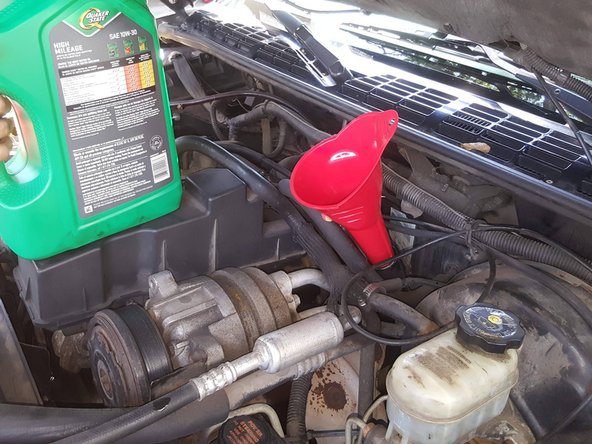

  4. Chevy s10 extreme pickup truck 1999, Add oil: crwdns2935265:04crwdnd2935265:01crwdnd2935265:01crwdne2935265:0
    • Add 4 qt of oil
    • Check under vehicle to make sure there is not oil spilling.
