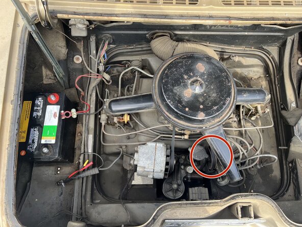

Chevy Corvair Fan Belt Replacement
  1. Chevy Corvair Fan Belt Replacement, Fan belt: crwdns2935265:01crwdnd2935265:01crwdnd2935265:03crwdne2935265:0 Chevy Corvair Fan Belt Replacement, Fan belt: crwdns2935265:01crwdnd2935265:02crwdnd2935265:03crwdne2935265:0 Chevy Corvair Fan Belt Replacement, Fan belt: crwdns2935265:01crwdnd2935265:03crwdnd2935265:03crwdne2935265:0

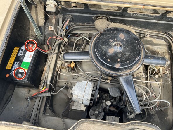

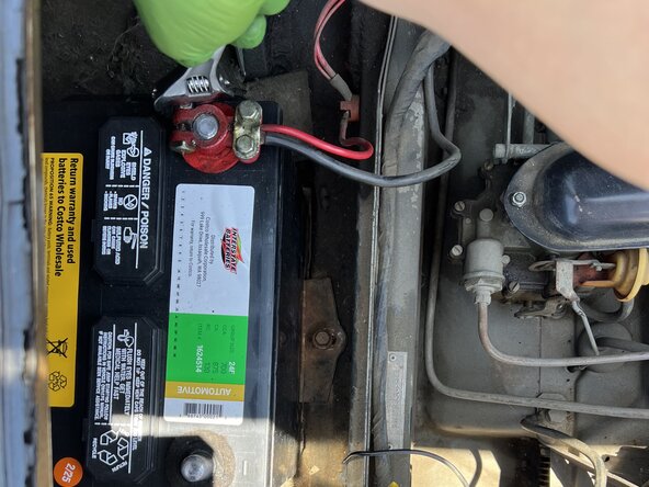

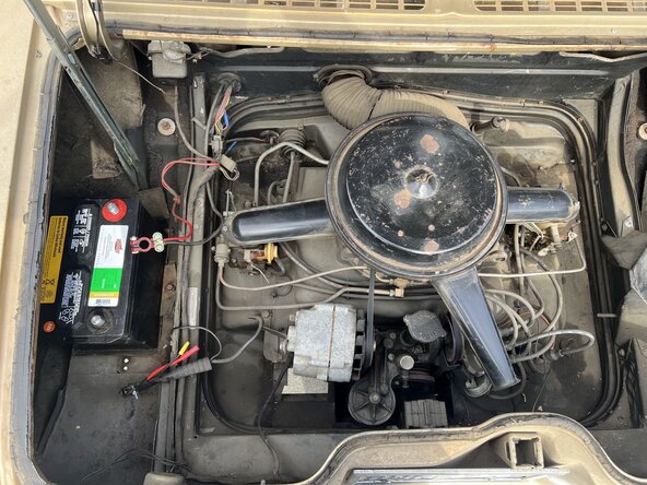

    • Disconnect the negative terminal and then the positive terminal from the battery.
  2. Chevy Corvair Fan Belt Replacement: crwdns2935265:02crwdnd2935265:01crwdnd2935265:02crwdne2935265:0 Chevy Corvair Fan Belt Replacement: crwdns2935265:02crwdnd2935265:02crwdnd2935265:02crwdne2935265:0

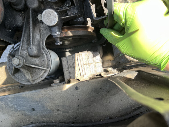

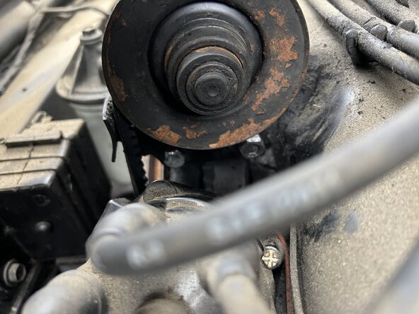

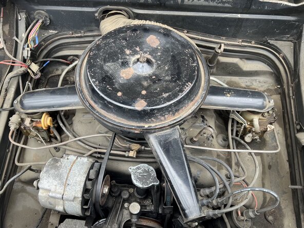

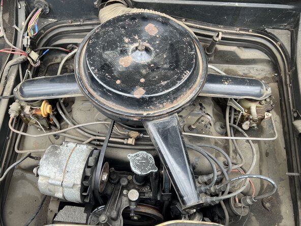

    • You have to locate the idle pulley which is usually on the right hand side of the track.

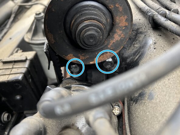

  3. Chevy Corvair Fan Belt Replacement: crwdns2935265:03crwdnd2935265:01crwdnd2935265:02crwdne2935265:0 Chevy Corvair Fan Belt Replacement: crwdns2935265:03crwdnd2935265:02crwdnd2935265:02crwdne2935265:0

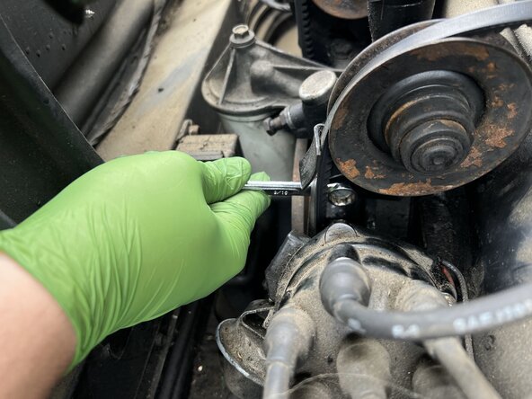

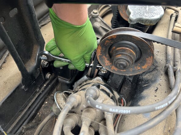

    • Find the 2 bolts on the idle pulley
    • Use a 9/16 wrench to relieve the tension on the vehicle then you have to loosen both of the bolt.

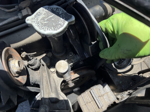

  4. Chevy Corvair Fan Belt Replacement: crwdns2935265:04crwdnd2935265:01crwdnd2935265:03crwdne2935265:0 Chevy Corvair Fan Belt Replacement: crwdns2935265:04crwdnd2935265:02crwdnd2935265:03crwdne2935265:0 Chevy Corvair Fan Belt Replacement: crwdns2935265:04crwdnd2935265:03crwdnd2935265:03crwdne2935265:0

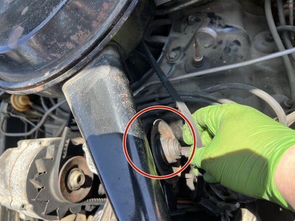

    • You should start by removing the belt from the idle pulley.
    • You want to start working your way around from the bottom and the alternator to take off the belt.

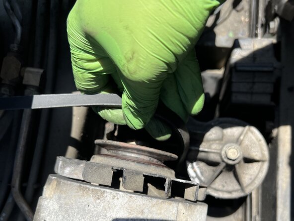

  5. Chevy Corvair Fan Belt Replacement: crwdns2935265:05crwdnd2935265:01crwdnd2935265:03crwdne2935265:0 Chevy Corvair Fan Belt Replacement: crwdns2935265:05crwdnd2935265:02crwdnd2935265:03crwdne2935265:0 Chevy Corvair Fan Belt Replacement: crwdns2935265:05crwdnd2935265:03crwdnd2935265:03crwdne2935265:0

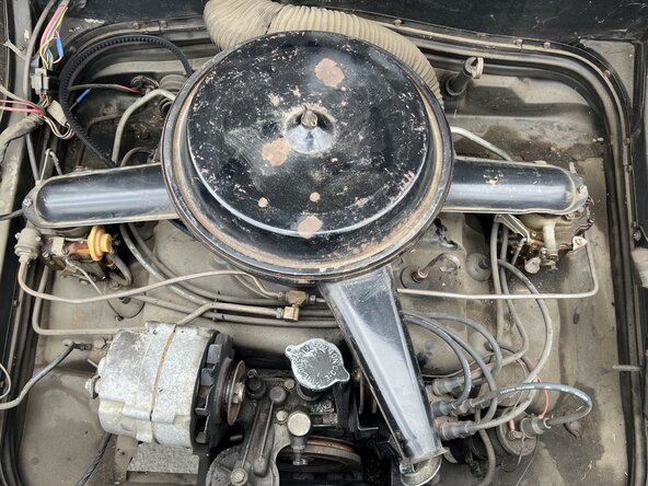

    • Make sure to clean the pulleys and the path before putting on the the belt.
    • Start by putting the belt on the top and working your way around before finishing by putting it on the idle pulley.
    • Make sure the belt is on the path correctly.
  6. Chevy Corvair Fan Belt Replacement: crwdns2935265:06crwdnd2935265:01crwdnd2935265:02crwdne2935265:0 Chevy Corvair Fan Belt Replacement: crwdns2935265:06crwdnd2935265:02crwdnd2935265:02crwdne2935265:0
    • You can end it off by tightening the bolts and make sure to not make the path too tight.
    • Make sure you can still move the pulley to insure there isn't too much tension on the belt.
Make sure there isn't too much tension on the belt and you'll be good to go.
