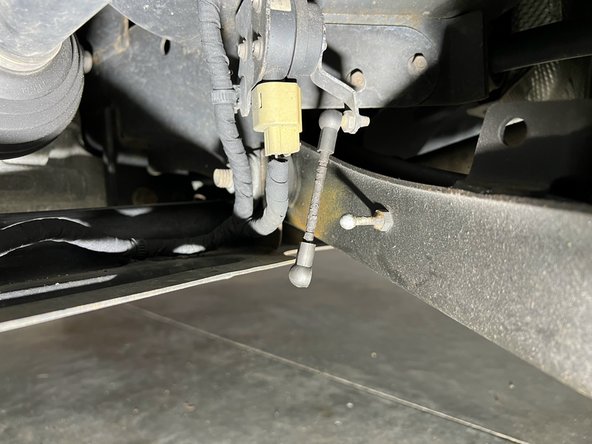

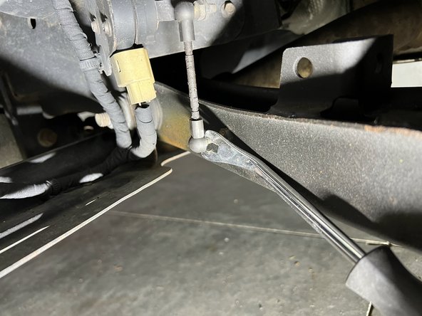

  6. Chevrolet SS Sedan Rear Shock Absorber Replacement, Suspension Height Sensor Link: crwdns2935265:06crwdnd2935265:01crwdnd2935265:03crwdne2935265:0 Chevrolet SS Sedan Rear Shock Absorber Replacement, Suspension Height Sensor Link: crwdns2935265:06crwdnd2935265:02crwdnd2935265:03crwdne2935265:0 Chevrolet SS Sedan Rear Shock Absorber Replacement, Suspension Height Sensor Link: crwdns2935265:06crwdnd2935265:03crwdnd2935265:03crwdne2935265:0
    • There's a small arm linking the lower control arm to a vehicle height sensor.
    • Separate the link from the lower control arm
    • It takes a little force to pop the linkage off, a flat head screwdriver or trim removal tool can make the process easier.

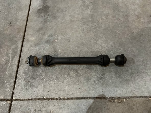

  7. Chevrolet SS Sedan Rear Shock Absorber Replacement, Stabilizer Bar Link: crwdns2935265:07crwdnd2935265:01crwdnd2935265:03crwdne2935265:0 Chevrolet SS Sedan Rear Shock Absorber Replacement, Stabilizer Bar Link: crwdns2935265:07crwdnd2935265:02crwdnd2935265:03crwdne2935265:0 Chevrolet SS Sedan Rear Shock Absorber Replacement, Stabilizer Bar Link: crwdns2935265:07crwdnd2935265:03crwdnd2935265:03crwdne2935265:0
    • Using a 15mm wrench and socket, remove the stabilizer bar link
    • The brake line runs near the top of this link, to avoid damaging it you should hold the top nut with a wrench and turn the bolt from the bottom. Picture #2 is incorrect, the ratchet should be on the bottom!
    • Pressure from the suspension may keep the middle plastic "grommet" section in place, you can wiggle it out or wait until the lower control arm is fully freed to remove it.
    • When reassembling, torque this to around 30ft-lbs.

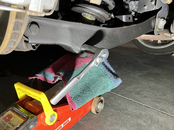

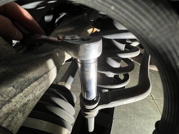

  8. Chevrolet SS Sedan Rear Shock Absorber Replacement, Disconnect Strut from the Control Arm: crwdns2935265:08crwdnd2935265:01crwdnd2935265:03crwdne2935265:0 Chevrolet SS Sedan Rear Shock Absorber Replacement, Disconnect Strut from the Control Arm: crwdns2935265:08crwdnd2935265:02crwdnd2935265:03crwdne2935265:0 Chevrolet SS Sedan Rear Shock Absorber Replacement, Disconnect Strut from the Control Arm: crwdns2935265:08crwdnd2935265:03crwdnd2935265:03crwdne2935265:0
    • A single 18mm nut and bolt secures the strut assembly to the lower control arm
    • Remove the nut with a ratchet while holding the other side with wrench
    • When re-assembling, this should be torqued to about 60ft-lbs, then tightened an additional quarter turn.
    • If you cannot get the bolt out, use a jack to lift the lower control arm such that there is no force on the bolt. A small hammer can be used to tap the bolt out, but be careful not to damage the threads!
    • When re-assembling, the jack will be necessary to align the control arm and strut to re-install the nut and bolt.

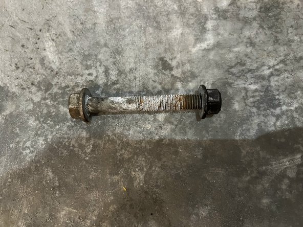

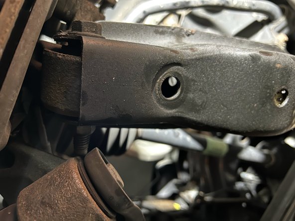

  9. Chevrolet SS Sedan Rear Shock Absorber Replacement, Separate Knuckle from Lower Control Arm: crwdns2935265:09crwdnd2935265:01crwdnd2935265:03crwdne2935265:0 Chevrolet SS Sedan Rear Shock Absorber Replacement, Separate Knuckle from Lower Control Arm: crwdns2935265:09crwdnd2935265:02crwdnd2935265:03crwdne2935265:0 Chevrolet SS Sedan Rear Shock Absorber Replacement, Separate Knuckle from Lower Control Arm: crwdns2935265:09crwdnd2935265:03crwdnd2935265:03crwdne2935265:0
    • An 18mm nut and bolt secures the lower control arm to the rear knuckle and must be removed.
    • Like the strut-to-LCA bolt, this may require "finessing" the lower control arm with a jack to remove.
    • When reassembling, torque this to around 35ft-lbs. You will need to do some prying with a pry-bar or large screwdriver in concert with a jack to get this realigned so you can re-insert the bolt.
    • This nut is identical to the one removed in the previous step, but the bolt is shorter. Don't mix them up!
    • After this step, the lower control arm should move freely.

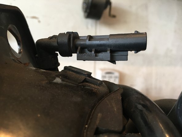

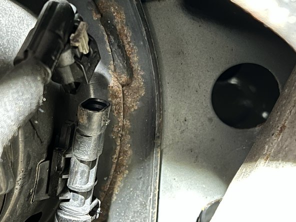

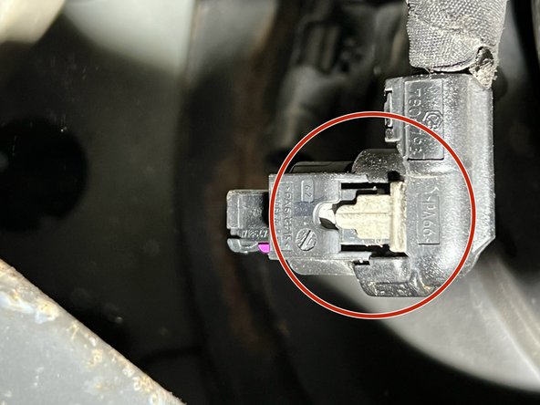

  10. Chevrolet SS Sedan Rear Shock Absorber Replacement, Strut Electrical Connection: crwdns2935265:010crwdnd2935265:01crwdnd2935265:03crwdne2935265:0 Chevrolet SS Sedan Rear Shock Absorber Replacement, Strut Electrical Connection: crwdns2935265:010crwdnd2935265:02crwdnd2935265:03crwdne2935265:0 Chevrolet SS Sedan Rear Shock Absorber Replacement, Strut Electrical Connection: crwdns2935265:010crwdnd2935265:03crwdnd2935265:03crwdne2935265:0
    • The strut is electrically connected to the car via a 2-pin connector near where the strut mounts to the body.
    • There's a small tab on the connector which you must depress to get it disconnected.

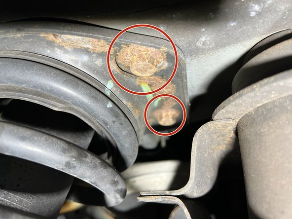

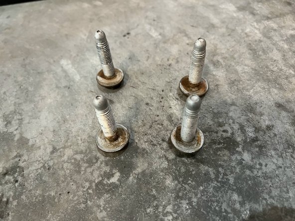

  11. Chevrolet SS Sedan Rear Shock Absorber Replacement, Strut to Body Bolts: crwdns2935265:011crwdnd2935265:01crwdnd2935265:03crwdne2935265:0 Chevrolet SS Sedan Rear Shock Absorber Replacement, Strut to Body Bolts: crwdns2935265:011crwdnd2935265:02crwdnd2935265:03crwdne2935265:0 Chevrolet SS Sedan Rear Shock Absorber Replacement, Strut to Body Bolts: crwdns2935265:011crwdnd2935265:03crwdnd2935265:03crwdne2935265:0
    • Four 15mm bolts attach the strut to the body of the vehicle.
    • These bolts seem to have gotten pretty rusty despite my car not being driven in a salty environment, it may be wise to replace them when replacing the strut.
    • Remove the bolts, the strut should come free from the body.
    • When re-assembling, these bolts should be torqued to around 45ft-lbs.

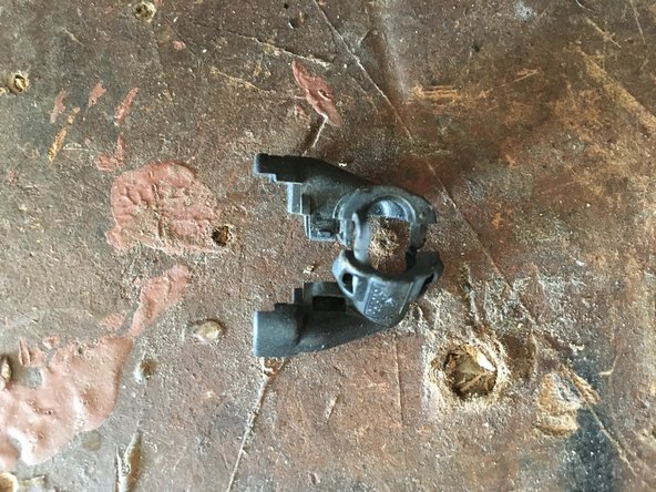

  14. Chevrolet SS Sedan Rear Shock Absorber Replacement, Separating Connector from Strut: crwdns2935265:015crwdnd2935265:01crwdnd2935265:03crwdne2935265:0 Chevrolet SS Sedan Rear Shock Absorber Replacement, Separating Connector from Strut: crwdns2935265:015crwdnd2935265:02crwdnd2935265:03crwdne2935265:0 Chevrolet SS Sedan Rear Shock Absorber Replacement, Separating Connector from Strut: crwdns2935265:015crwdnd2935265:03crwdnd2935265:03crwdne2935265:0
    • The 2-pin connector at the top of the strut assembly slides into a grove, slide it out!
    • There's an angled shell which wraps around the base of the connector, press on plastic tabs to remove it from the connector and set it aside.

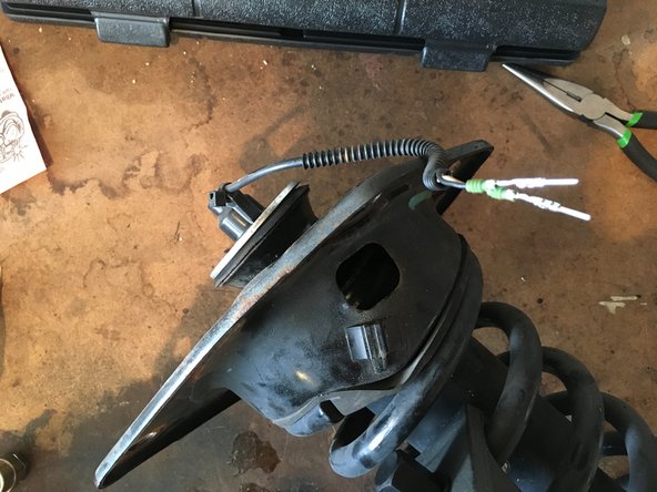

  15. Chevrolet SS Sedan Rear Shock Absorber Replacement, De-pinning the Connector: crwdns2935265:016crwdnd2935265:01crwdnd2935265:01crwdne2935265:0
    • You may have noticed that the electrical connector is larger than the hole at the top of the strut, it can't be slid through!
    • The pins must be removed from the connector housing, this process requires some finesse.
    • Make a "depinning tool" with a standard sized paperclip by bending it as shown
    • Straighten most of the paperclip, but bend the end slightly
    • This will be used to release the pins from the connector housing

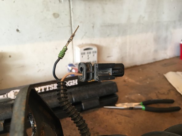

  16. Chevrolet SS Sedan Rear Shock Absorber Replacement, De-pinning the Connector (part 2): crwdns2935265:017crwdnd2935265:01crwdnd2935265:03crwdne2935265:0 Chevrolet SS Sedan Rear Shock Absorber Replacement, De-pinning the Connector (part 2): crwdns2935265:017crwdnd2935265:02crwdnd2935265:03crwdne2935265:0 Chevrolet SS Sedan Rear Shock Absorber Replacement, De-pinning the Connector (part 2): crwdns2935265:017crwdnd2935265:03crwdnd2935265:03crwdne2935265:0
    • To release the pins from the connector, press the paperclip into the purple holes adjacent to each pin
    • While pressing the paperclip into the hole, gently pull the wire from the back of the connector while wiggling the paperclip
    • It shouldn't take much force to remove the pins when you correctly align the paperclip, do not force this apart because you can break the connector or wire!
    • Pay attention to how the pins sit in the housing, the pin must align with the connector housing when reassembled
  17. Chevrolet SS Sedan Rear Shock Absorber Replacement, De-pinning the Connector (part 3): crwdns2935265:018crwdnd2935265:01crwdnd2935265:02crwdne2935265:0 Chevrolet SS Sedan Rear Shock Absorber Replacement, De-pinning the Connector (part 3): crwdns2935265:018crwdnd2935265:02crwdnd2935265:02crwdne2935265:0
    • With both pins removed from the connector, you can slide them through the top part of the strut.

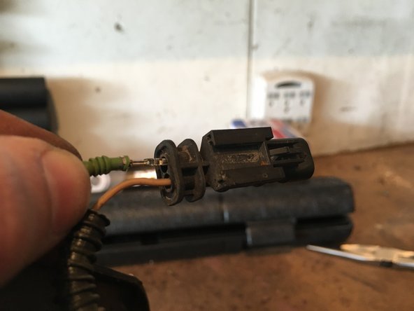

  18. Chevrolet SS Sedan Rear Shock Absorber Replacement, A Note About Pinout: crwdns2935265:019crwdnd2935265:01crwdnd2935265:02crwdne2935265:0 Chevrolet SS Sedan Rear Shock Absorber Replacement, A Note About Pinout: crwdns2935265:019crwdnd2935265:02crwdnd2935265:02crwdne2935265:0
    • The orientation of the colored wires in the connector is different on the driver and passenger side struts.
    • The first image shows the driver side pinout with one of the wires partially removed
    • The second image shows the passenger side pinout with one of the wires removed
    • Look closely at the connector shell orientation in both pictures, as well as the orientation of the black / orange wire.

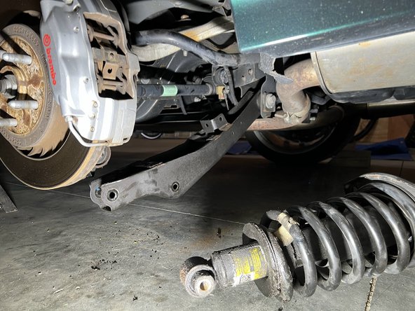

  20. Chevrolet SS Sedan Rear Shock Absorber Replacement, Compress the Strut: crwdns2935265:021crwdnd2935265:01crwdnd2935265:01crwdne2935265:0
    • Using MacPherson strut compressors, compress the spring slightly.
    • You only need to compress the strut by around half an inch, just enough to allow further disassembly.

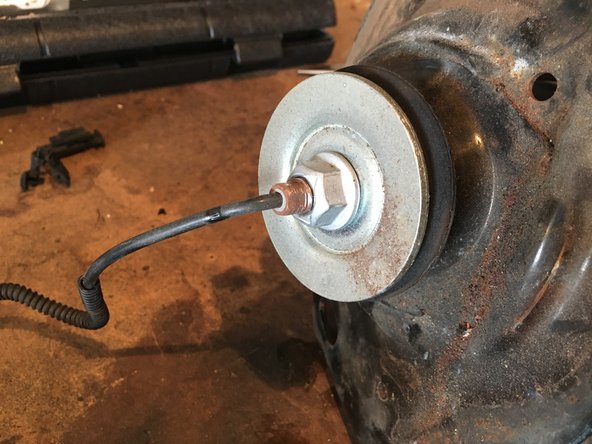

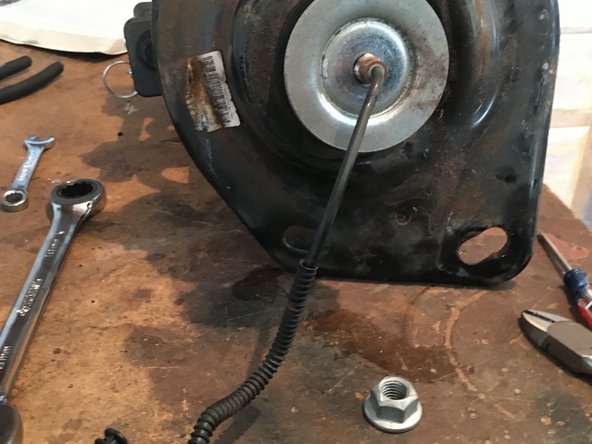

  21. Chevrolet SS Sedan Rear Shock Absorber Replacement, Strut Nut: crwdns2935265:022crwdnd2935265:01crwdnd2935265:02crwdne2935265:0 Chevrolet SS Sedan Rear Shock Absorber Replacement, Strut Nut: crwdns2935265:022crwdnd2935265:02crwdnd2935265:02crwdne2935265:0
    • Hold the center shaft of the strut with a 3/8" wrench while removing the nut at the top of the strut with an 18mm wrench.
    • Slide the nut over the cable and remove it
    • When reassembling, torque the nut to around 35ft-lbs.
    • If you don't have an open-ended 18mm socket, get a good feel for the torque when you remove the nut so you can reassemble similarly.
  22. Chevrolet SS Sedan Rear Shock Absorber Replacement, Strut Disassembly: crwdns2935265:023crwdnd2935265:01crwdnd2935265:01crwdne2935265:0
    • Remove the top washer, mounting plate/bushing, lower washer, and dust cap, keeping track of the order you removed them.
    • The removable components are shown left-to-right in the order they go onto the strut.

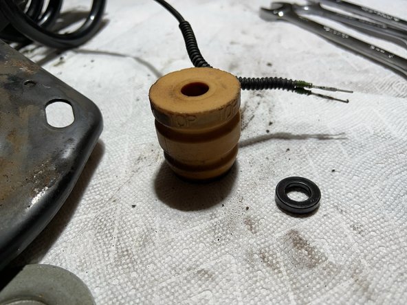

  23. Chevrolet SS Sedan Rear Shock Absorber Replacement, Strut Disassembly Pt. 2: crwdns2935265:024crwdnd2935265:01crwdnd2935265:02crwdne2935265:0 Chevrolet SS Sedan Rear Shock Absorber Replacement, Strut Disassembly Pt. 2: crwdns2935265:024crwdnd2935265:02crwdnd2935265:02crwdne2935265:0
    • Remove the small black washer and the yellow spacer.
    • The top of the spacer is labeled

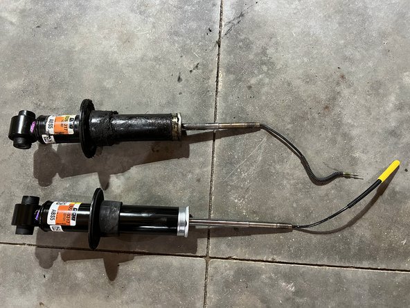

  24. Chevrolet SS Sedan Rear Shock Absorber Replacement, Damper Removal: crwdns2935265:025crwdnd2935265:01crwdnd2935265:02crwdne2935265:0 Chevrolet SS Sedan Rear Shock Absorber Replacement, Damper Removal: crwdns2935265:025crwdnd2935265:02crwdnd2935265:02crwdne2935265:0
    • You should now be able to slide the shock absorber out of the spring.
    • This shock absorber shows all the symptoms of failure, it's coated in oily ferrofluid and grime.
    • The new one is nice and clean!
