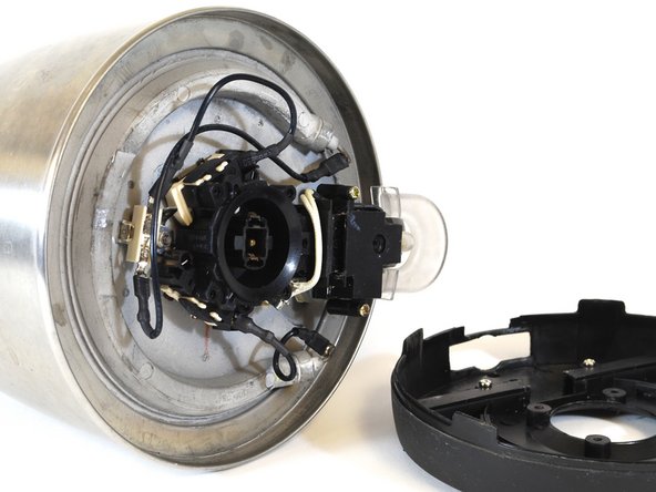

  4. ChefsChoice M677 Power Supply Replacement: crwdns2935265:04crwdnd2935265:01crwdnd2935265:01crwdne2935265:0
    • Now that you have removed the bottom from the kettle, identify all of the parts. The ORANGE arrows point to the posts for mounting the control circuit components. The RED arrows point to the following parts:
    • A: The power supply.
    • B: The two boil-dry protection switches, one on either side of the central black ring.
    • C: The power coupling. This fits into the baseplate when you place the kettle on it.
    • D: The thermostat. This is a little metal ring, half hidden by the switch cover.
    • E: The manual ON/OFF switch.
    • F: The indicator light.
    • G: The steam chamber. This heats the thermostat, which turns off the kettle automatically.

The photographs and schematic were very helpful, but the problem was not with the Power Supply; the on-off switch lit up. I needed to remove the two other nuts at the yellow arrows and look more closely at the Boil Dry Protection Switches. I removed and replaced the metal plates and noticed that two white plastic pieces swung out into the space around the Power Coupling. Had I reset something? Regardless, after reconnecting wires and reattaching nuts and screws, the pot is back to working order. Thank you so much for posting this Fix It!
