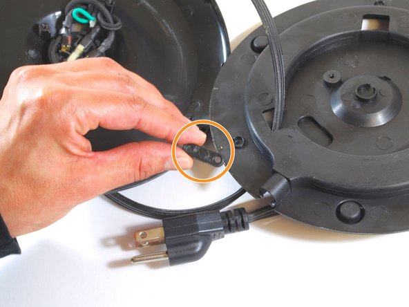

      • Reattach the black plastic oval piece in order to secure and stabilize the cord wires.

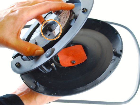

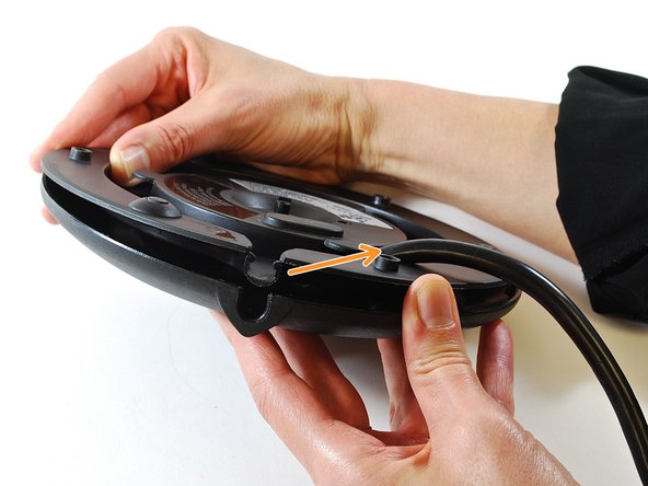

      • Align the two parts of the baseplate as shown in these two photos.
      • Push or pull on the cord as needed to ensure a stable fit before inserting the screws.
