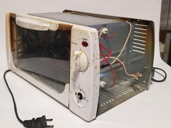

    • Examine the condition of the appliance.
    • Remove the tray from inside the toaster oven before dissembling.
    • With the tray removed, this is a great opportunity to clean your toaster oven . Built up debris left over time could lead to functional issues in the future!

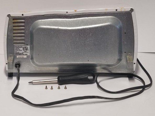

    • Flip the toaster oven on its head so that its bottom side is facing upwards.
    • Use a Phillips #0 screwdriver to remove the four screws hidden underneath the legs of the appliance.
    • There are two legs covering the two screws in the front peg .
    • The other two screws are visible under the back legs.

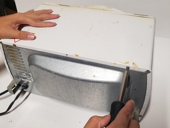

    • Return the toaster oven to its upright position and rotate it so its backside is facing you.
    • Use the Phillips #0 screwdriver to unscrew the four screws visible on the backside.
    • Keep track of loose screws for later re-assembly.

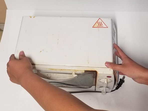

    • With the appliance facing you, remove the top cover of the toaster oven to access the timer location.

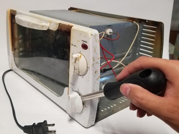

  5. Chefmate TO-09 Timer Replacement: crwdns2935265:05crwdnd2935265:01crwdnd2935265:03crwdne2935265:0 Chefmate TO-09 Timer Replacement: crwdns2935265:05crwdnd2935265:02crwdnd2935265:03crwdne2935265:0 Chefmate TO-09 Timer Replacement: crwdns2935265:05crwdnd2935265:03crwdnd2935265:03crwdne2935265:0
    • Use the flat screwdriver as a wedge and pop the timer knob out of place.
    • If you have difficulty removing the timer by hand, use a flat plier to pry off the timer knob.

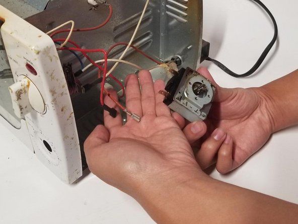

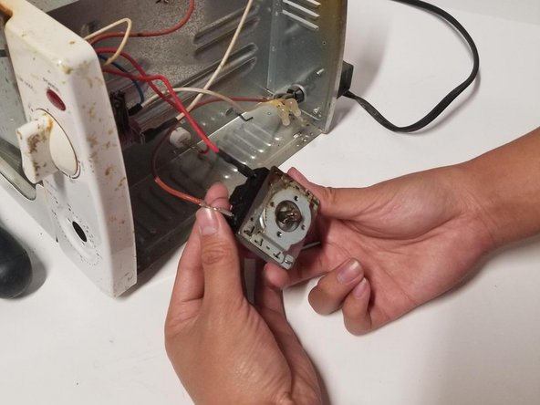

  6. Chefmate TO-09 Timer Replacement: crwdns2935265:06crwdnd2935265:01crwdnd2935265:03crwdne2935265:0 Chefmate TO-09 Timer Replacement: crwdns2935265:06crwdnd2935265:02crwdnd2935265:03crwdne2935265:0 Chefmate TO-09 Timer Replacement: crwdns2935265:06crwdnd2935265:03crwdnd2935265:03crwdne2935265:0

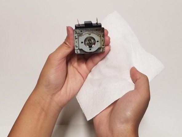

    • With the timer in hand, gently remove the two wires attached to the square object.
    • Unplug the timer wire gently, or else this may cause damage to the cables.
  7. Chefmate TO-09 Timer Replacement: crwdns2935265:07crwdnd2935265:01crwdnd2935265:03crwdne2935265:0 Chefmate TO-09 Timer Replacement: crwdns2935265:07crwdnd2935265:02crwdnd2935265:03crwdne2935265:0 Chefmate TO-09 Timer Replacement: crwdns2935265:07crwdnd2935265:03crwdnd2935265:03crwdne2935265:0

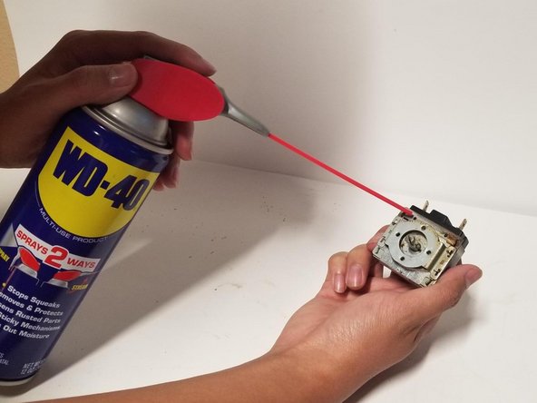

    • Before replacing your timer with a new one, you may try to lubricate it first to see if it fixes the issue.
    • Apply WD-40 to the timer's slight peek edge.
    • Let the WD-40 sit and take effect for around 30 seconds or a minute after you spray it onto the timer.
    • The WD-40's oil will seep inside the timer, reaching the tiny gear of the timer.
    • WD-40 is flammable. Be sure to read the instruction label before using WD-40 Two-Way Spray Can.
    • Not cleaning/wiping off excess WD-40 oil on the timer will start a fire in the toaster oven.
    • You can test the timer using a flat head screwdriver to turn the timer to see if it ticks/works.
