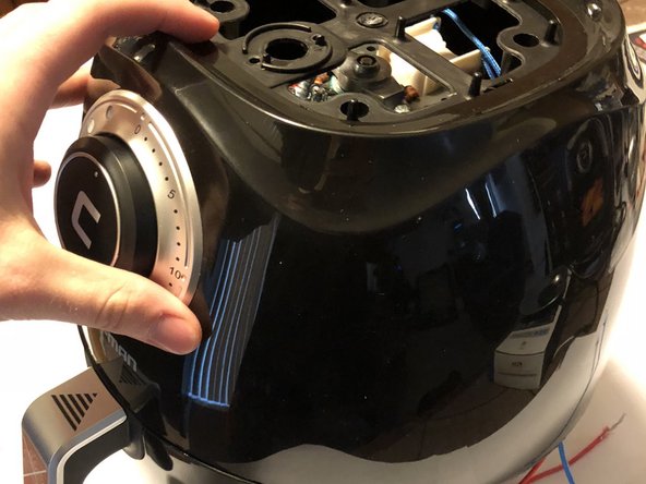

      • Using the plastic opening tool, pop off each of the four corners on the top silver plate.
    2. Chefman RJ38-V2-35 Timer Replacement: crwdns2935265:02crwdnd2935265:01crwdnd2935265:01crwdne2935265:0
      • Twist off the temperature knob.
    3. Chefman RJ38-V2-35 Timer Replacement: crwdns2935265:03crwdnd2935265:01crwdnd2935265:02crwdne2935265:0 Chefman RJ38-V2-35 Timer Replacement: crwdns2935265:03crwdnd2935265:02crwdnd2935265:02crwdne2935265:0

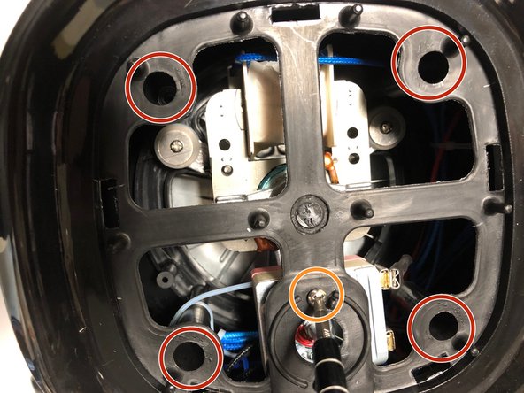

      • Using a Phillips #1 screwdriver, remove the four 4mm screws, one in each corner.
      • Also unscrew two 4mm screws.
    4. Chefman RJ38-V2-35 Timer Replacement: crwdns2935265:04crwdnd2935265:01crwdnd2935265:02crwdne2935265:0 Chefman RJ38-V2-35 Timer Replacement: crwdns2935265:04crwdnd2935265:02crwdnd2935265:02crwdne2935265:0
      • Pull off top black cover.
