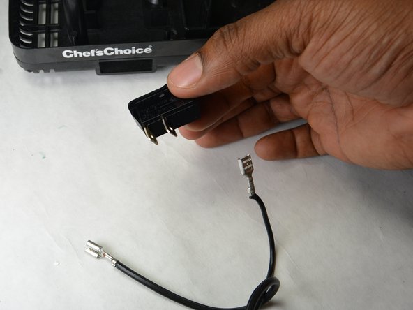

    • Using a screw driver, unclip the edges of the switch by pushing them inwards and nudging the switch out of the plastic casing. You will hear a click when the edges unhook from the casing.
  7. Chef's Choice M115 Power Switch Replacement: crwdns2935265:07crwdnd2935265:01crwdnd2935265:02crwdne2935265:0 Chef's Choice M115 Power Switch Replacement: crwdns2935265:07crwdnd2935265:02crwdnd2935265:02crwdne2935265:0
    • Remove the spade connectors from the switch by pulling only on the connector, not the wire.
    • This may require a fair bit of force. Use caution to not damage the device, yourself, or your surroundings.
