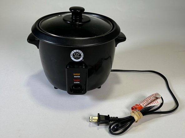

Chef’s Counter Rice Cooker RC-3 Disassembly
  1. Chef’s Counter Rice Cooker RC-3 Disassembly, Chef’s Counter Rice Cooker RC-3: crwdns2935265:01crwdnd2935265:01crwdnd2935265:03crwdne2935265:0 Chef’s Counter Rice Cooker RC-3 Disassembly, Chef’s Counter Rice Cooker RC-3: crwdns2935265:01crwdnd2935265:02crwdnd2935265:03crwdne2935265:0 Chef’s Counter Rice Cooker RC-3 Disassembly, Chef’s Counter Rice Cooker RC-3: crwdns2935265:01crwdnd2935265:03crwdnd2935265:03crwdne2935265:0

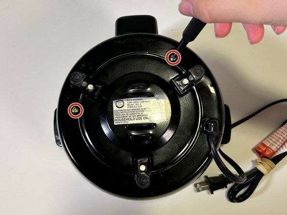

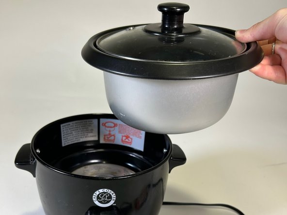

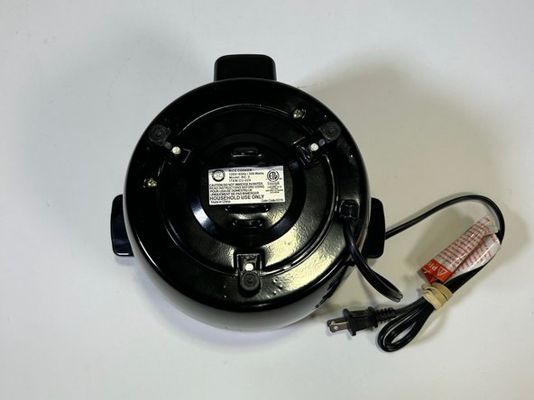

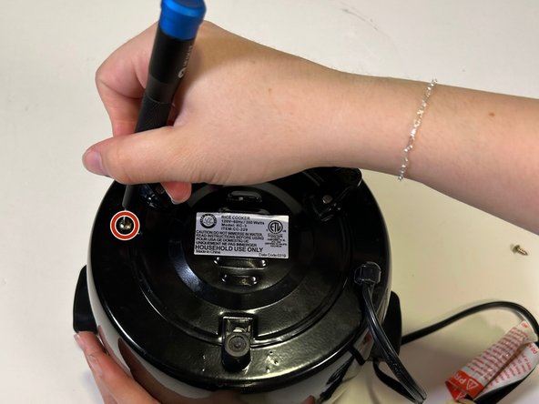

    • Unplug the rice cooker.
    • Remove the bowl and lid from the device and place the device upside down on a flat surface.

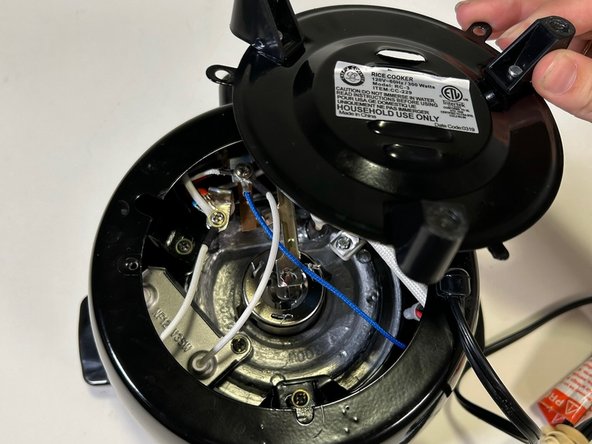

  2. Chef’s Counter Rice Cooker RC-3 Disassembly: crwdns2935265:02crwdnd2935265:01crwdnd2935265:03crwdne2935265:0 Chef’s Counter Rice Cooker RC-3 Disassembly: crwdns2935265:02crwdnd2935265:02crwdnd2935265:03crwdne2935265:0 Chef’s Counter Rice Cooker RC-3 Disassembly: crwdns2935265:02crwdnd2935265:03crwdnd2935265:03crwdne2935265:0
    • Remove the two 13 mm screws from the bottom using a Phillips #1 screwdriver.
    • Remove the base plate.

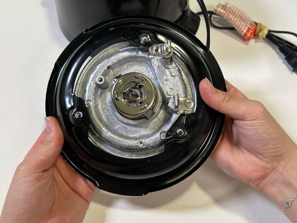

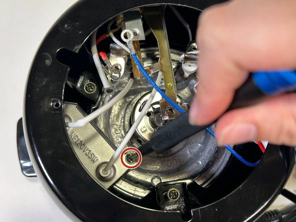

  3. Chef’s Counter Rice Cooker RC-3 Disassembly: crwdns2935265:03crwdnd2935265:01crwdnd2935265:03crwdne2935265:0 Chef’s Counter Rice Cooker RC-3 Disassembly: crwdns2935265:03crwdnd2935265:02crwdnd2935265:03crwdne2935265:0 Chef’s Counter Rice Cooker RC-3 Disassembly: crwdns2935265:03crwdnd2935265:03crwdnd2935265:03crwdne2935265:0

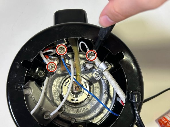

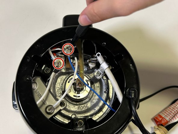

    • Remove the three 10 mm gold screws holding the wires in place using a Phillips #1 screwdriver.

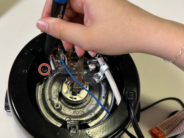

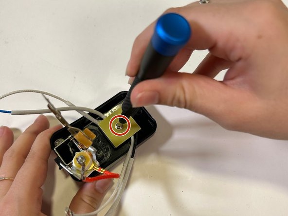

  4. Chef’s Counter Rice Cooker RC-3 Disassembly: crwdns2935265:04crwdnd2935265:01crwdnd2935265:03crwdne2935265:0 Chef’s Counter Rice Cooker RC-3 Disassembly: crwdns2935265:04crwdnd2935265:02crwdnd2935265:03crwdne2935265:0 Chef’s Counter Rice Cooker RC-3 Disassembly: crwdns2935265:04crwdnd2935265:03crwdnd2935265:03crwdne2935265:0

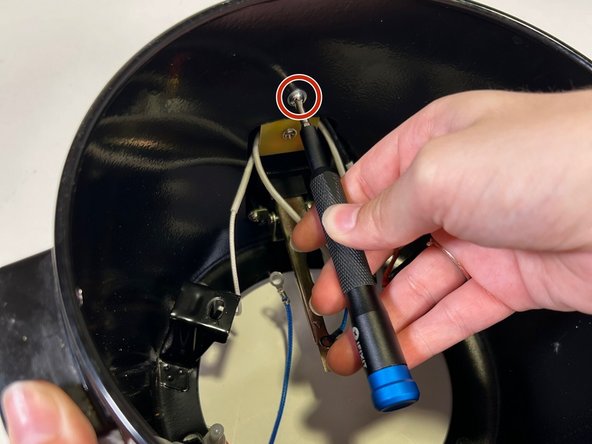

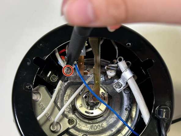

    • Remove the single 10 mm screw from the metal plate using a Phillips #1 screwdriver.
    • Remove the metal plate.

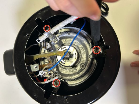

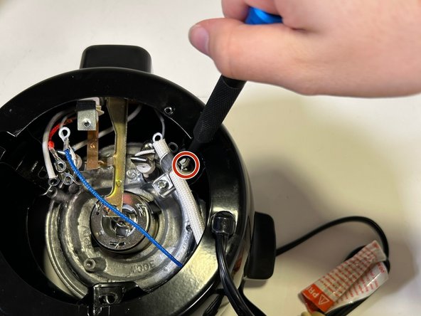

  5. Chef’s Counter Rice Cooker RC-3 Disassembly: crwdns2935265:05crwdnd2935265:01crwdnd2935265:03crwdne2935265:0 Chef’s Counter Rice Cooker RC-3 Disassembly: crwdns2935265:05crwdnd2935265:02crwdnd2935265:03crwdne2935265:0 Chef’s Counter Rice Cooker RC-3 Disassembly: crwdns2935265:05crwdnd2935265:03crwdnd2935265:03crwdne2935265:0
    • Remove the three perimeter screws holding the heating plate in place using a Phillips #1 screwdriver.
    • One screw has a length of 14 mm and two screws are 10 mm.

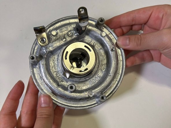

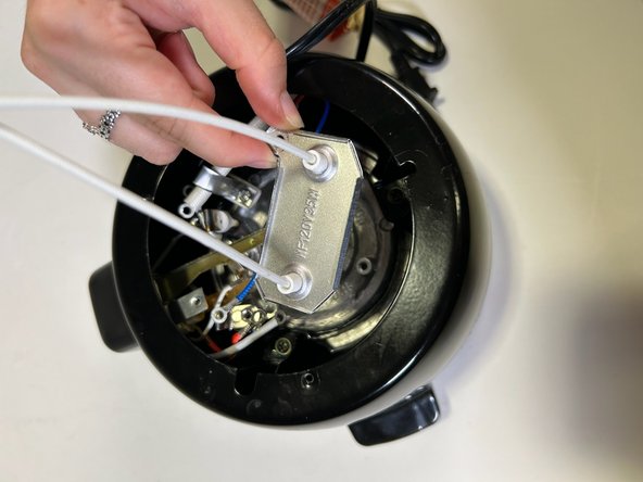

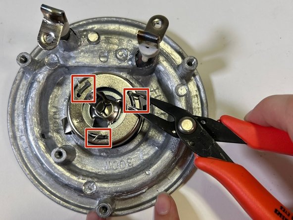

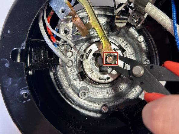

  6. Chef’s Counter Rice Cooker RC-3 Disassembly: crwdns2935265:06crwdnd2935265:01crwdnd2935265:03crwdne2935265:0 Chef’s Counter Rice Cooker RC-3 Disassembly: crwdns2935265:06crwdnd2935265:02crwdnd2935265:03crwdne2935265:0 Chef’s Counter Rice Cooker RC-3 Disassembly: crwdns2935265:06crwdnd2935265:03crwdnd2935265:03crwdne2935265:0
    • Use pliers to pinch the metal V in the center.
    • Slide out the silver heating component and black support ring.

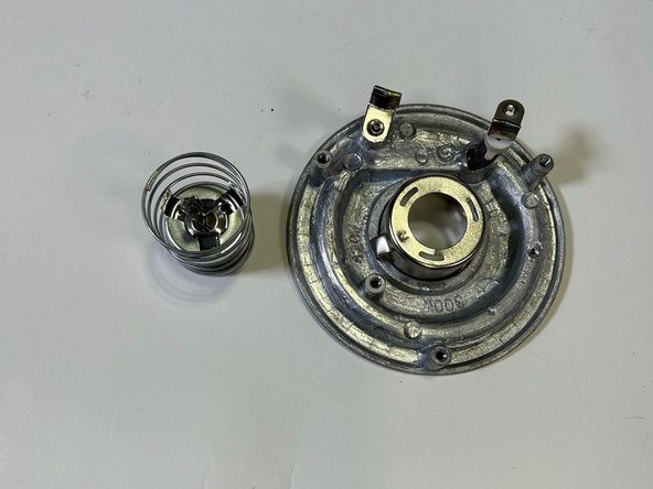

  7. Chef’s Counter Rice Cooker RC-3 Disassembly: crwdns2935265:07crwdnd2935265:01crwdnd2935265:03crwdne2935265:0 Chef’s Counter Rice Cooker RC-3 Disassembly: crwdns2935265:07crwdnd2935265:02crwdnd2935265:03crwdne2935265:0 Chef’s Counter Rice Cooker RC-3 Disassembly: crwdns2935265:07crwdnd2935265:03crwdnd2935265:03crwdne2935265:0
    • Use the pliers to pinch the three metal flaps flat and remove the spring.

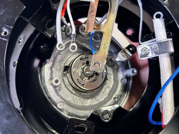

  8. Chef’s Counter Rice Cooker RC-3 Disassembly: crwdns2935265:08crwdnd2935265:01crwdnd2935265:02crwdne2935265:0 Chef’s Counter Rice Cooker RC-3 Disassembly: crwdns2935265:08crwdnd2935265:02crwdnd2935265:02crwdne2935265:0

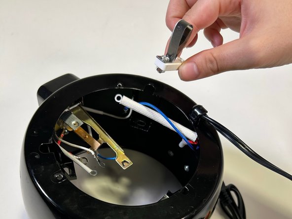

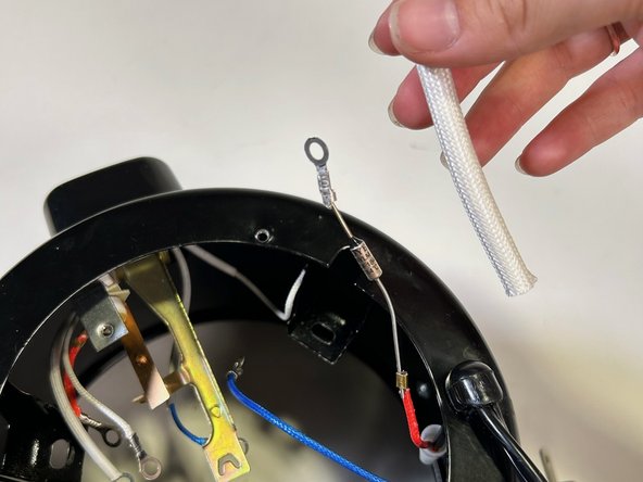

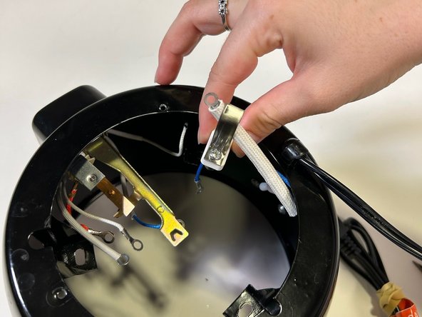

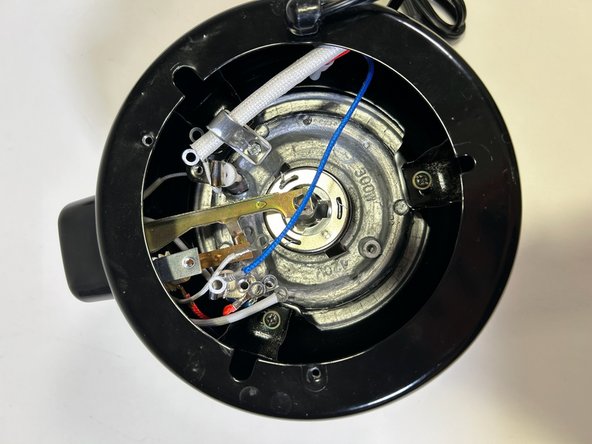

    • Remove the metal hook that is over the thick white wire cover.

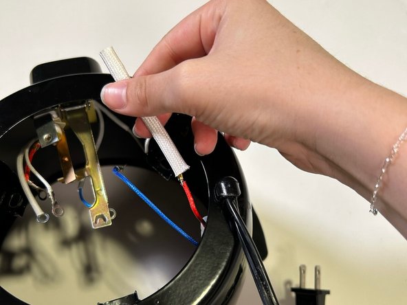

  9. Chef’s Counter Rice Cooker RC-3 Disassembly: crwdns2935265:09crwdnd2935265:01crwdnd2935265:02crwdne2935265:0 Chef’s Counter Rice Cooker RC-3 Disassembly: crwdns2935265:09crwdnd2935265:02crwdnd2935265:02crwdne2935265:0

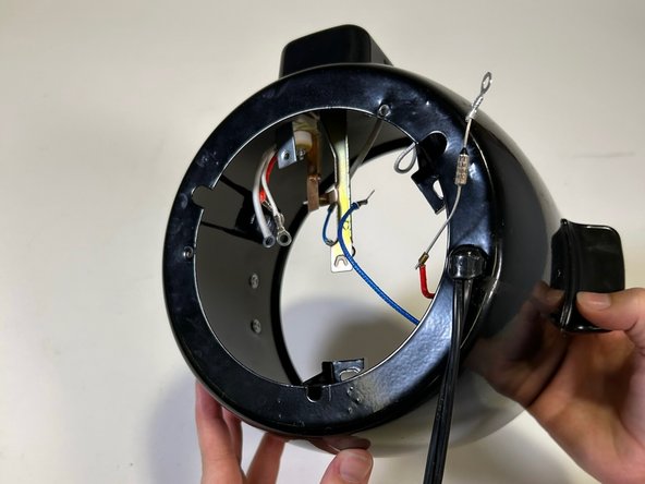

    • Remove the thick white wire cover uncovering the thermal cutoff fuse.
  10. Chef’s Counter Rice Cooker RC-3 Disassembly: crwdns2935265:010crwdnd2935265:01crwdnd2935265:02crwdne2935265:0 Chef’s Counter Rice Cooker RC-3 Disassembly: crwdns2935265:010crwdnd2935265:02crwdnd2935265:02crwdne2935265:0

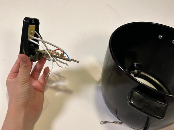

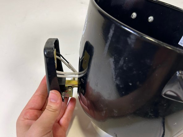

    • Flip over the rice cooker so it is right side up.

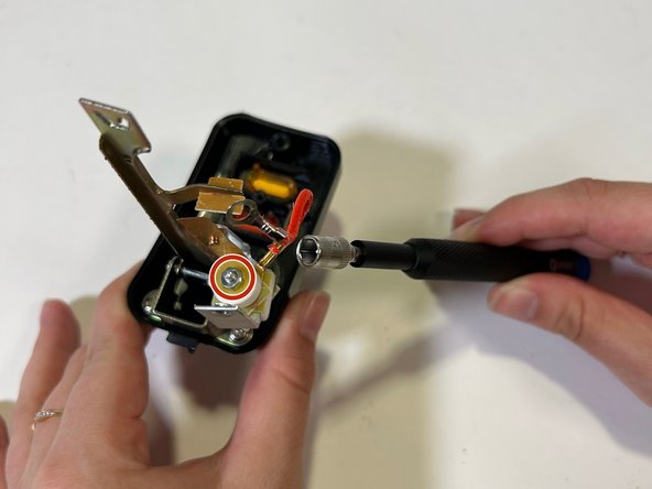

  11. Chef’s Counter Rice Cooker RC-3 Disassembly: crwdns2935265:011crwdnd2935265:01crwdnd2935265:03crwdne2935265:0 Chef’s Counter Rice Cooker RC-3 Disassembly: crwdns2935265:011crwdnd2935265:02crwdnd2935265:03crwdne2935265:0 Chef’s Counter Rice Cooker RC-3 Disassembly: crwdns2935265:011crwdnd2935265:03crwdnd2935265:03crwdne2935265:0
    • Remove the single 10 mm screw from the outer control panel using a Phillips #1 screwdriver.
    • Remove the plastic outer control panel.

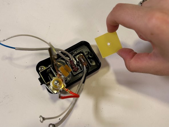

  12. Chef’s Counter Rice Cooker RC-3 Disassembly: crwdns2935265:012crwdnd2935265:01crwdnd2935265:03crwdne2935265:0 Chef’s Counter Rice Cooker RC-3 Disassembly: crwdns2935265:012crwdnd2935265:02crwdnd2935265:03crwdne2935265:0 Chef’s Counter Rice Cooker RC-3 Disassembly: crwdns2935265:012crwdnd2935265:03crwdnd2935265:03crwdne2935265:0
    • Remove the single 10 mm screw using a Phillips #1 screwdriver to reveal the LED lights.

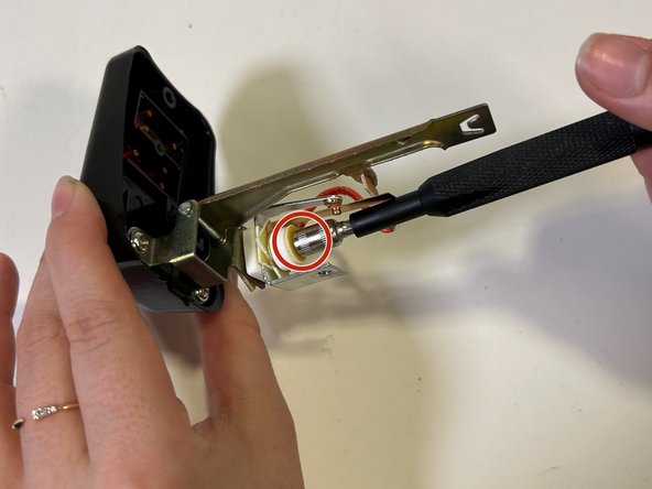

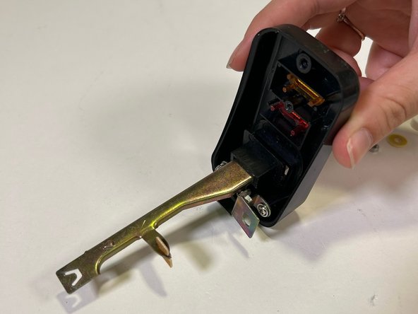

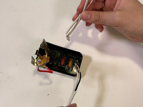

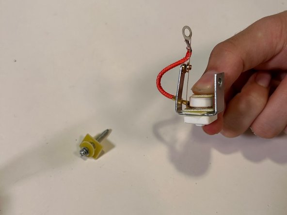

  13. Chef’s Counter Rice Cooker RC-3 Disassembly: crwdns2935265:013crwdnd2935265:01crwdnd2935265:03crwdne2935265:0 Chef’s Counter Rice Cooker RC-3 Disassembly: crwdns2935265:013crwdnd2935265:02crwdnd2935265:03crwdne2935265:0 Chef’s Counter Rice Cooker RC-3 Disassembly: crwdns2935265:013crwdnd2935265:03crwdnd2935265:03crwdne2935265:0
    • Remove the single 27 mm screw using a hex 5.5 screwdriver.
    • Extra hands are helpful because this component will easily fall apart.

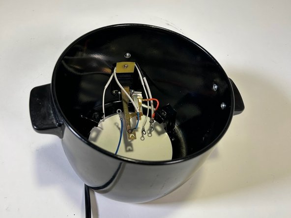

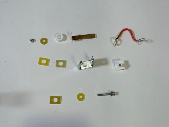

  14. Chef’s Counter Rice Cooker RC-3 Disassembly: crwdns2935265:014crwdnd2935265:01crwdnd2935265:02crwdne2935265:0 Chef’s Counter Rice Cooker RC-3 Disassembly: crwdns2935265:014crwdnd2935265:02crwdnd2935265:02crwdne2935265:0
    • Inspect the outer control panel, mechanical lever, and the components of the stack.
  15. Chef’s Counter Rice Cooker RC-3 Disassembly: crwdns2935265:015crwdnd2935265:01crwdnd2935265:01crwdne2935265:0
    • Now that the device is disassembled you can get a better understanding on how it works.
    • The rice cooker receives constant power when plugged in. A mechanical lever is used to switch between warm and cook settings. The settings are indicated by white LED lights with orange and red plastic coverings on the outer control panel.
    • A DF184S Thermal Cutoff Fuse is in place to protect the device by disconnecting the circuit in the event of a heating element malfunction.
