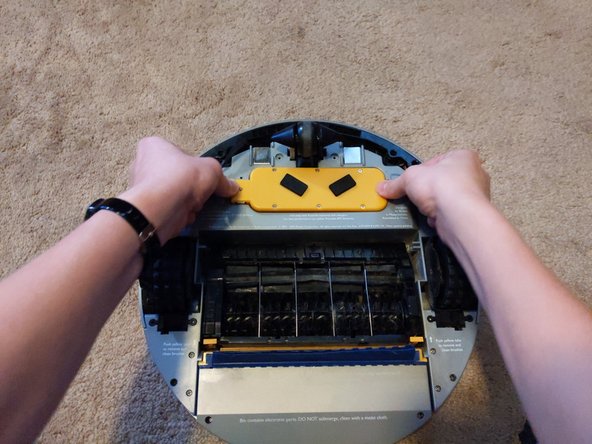

  2. Charging System reset, Remove the battery: crwdns2935265:02crwdnd2935265:01crwdnd2935265:03crwdne2935265:0 Charging System reset, Remove the battery: crwdns2935265:02crwdnd2935265:02crwdnd2935265:03crwdne2935265:0 Charging System reset, Remove the battery: crwdns2935265:02crwdnd2935265:03crwdnd2935265:03crwdne2935265:0
    • Depress the tabs on the sides of the battery and lift it out.
    • You may need to use descent force when lifting up.

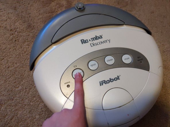

  3. Charging System reset, Reset the roomba: crwdns2935265:03crwdnd2935265:01crwdnd2935265:02crwdne2935265:0 Charging System reset, Reset the roomba: crwdns2935265:03crwdnd2935265:02crwdnd2935265:02crwdne2935265:0
    • Flip Roomba back over
    • Hold down Roomba's power button for 15 seconds.

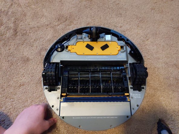

  4. Charging System reset, Reinstall the battery.: crwdns2935265:04crwdnd2935265:01crwdnd2935265:03crwdne2935265:0 Charging System reset, Reinstall the battery.: crwdns2935265:04crwdnd2935265:02crwdnd2935265:03crwdne2935265:0 Charging System reset, Reinstall the battery.: crwdns2935265:04crwdnd2935265:03crwdnd2935265:03crwdne2935265:0
    • Flip Roomba back over.
    • Reinsert the battery.
    • Flip Roomba over again.
  5. Charging System reset, Charge and run Roomba: crwdns2935265:05crwdnd2935265:01crwdnd2935265:01crwdne2935265:0
    • Charge Roomba for 16 hours and run on MAX cycle.
    • You should be done!
Perform an uninterrupted 16 hour charge. Then run on MAX cleaning cycle.
