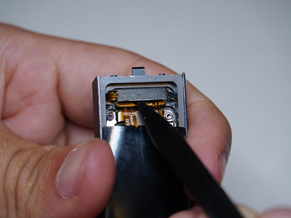

    1. Charge 3 Disassembly, Strap Connectors: crwdns2935265:01crwdnd2935265:01crwdnd2935265:03crwdne2935265:0 Charge 3 Disassembly, Strap Connectors: crwdns2935265:01crwdnd2935265:02crwdnd2935265:03crwdne2935265:0 Charge 3 Disassembly, Strap Connectors: crwdns2935265:01crwdnd2935265:03crwdnd2935265:03crwdne2935265:0
      • Remove both T3 screws
      • Slide off the plastic piece by lifting out and then up
      • Slide plastic and spring assembly off the rail

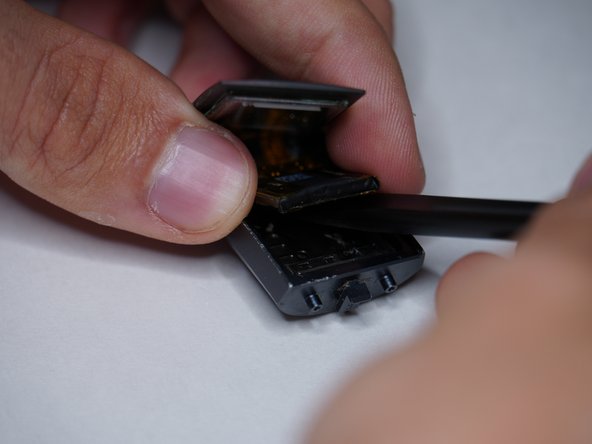

    2. Charge 3 Disassembly, Display: crwdns2935265:02crwdnd2935265:01crwdnd2935265:03crwdne2935265:0 Charge 3 Disassembly, Display: crwdns2935265:02crwdnd2935265:02crwdnd2935265:03crwdne2935265:0 Charge 3 Disassembly, Display: crwdns2935265:02crwdnd2935265:03crwdnd2935265:03crwdne2935265:0
      • Heat the glass screen with a blowdryer to soften the adhesives
      • Start the next step on the opposite side of the Fitbit wording below the glass. This is due to the display cables being located there
      • Insert a razor blade between the glass and the body
      • Keep going around the rim of the display until loose

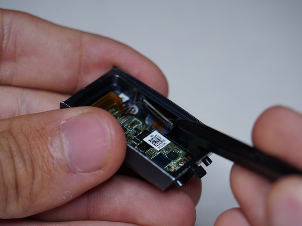

    4. Charge 3 Disassembly, Battery: crwdns2935265:04crwdnd2935265:01crwdnd2935265:03crwdne2935265:0 Charge 3 Disassembly, Battery: crwdns2935265:04crwdnd2935265:02crwdnd2935265:03crwdne2935265:0 Charge 3 Disassembly, Battery: crwdns2935265:04crwdnd2935265:03crwdnd2935265:03crwdne2935265:0
      • Lift display up gently
      • The battery is attached with a little bit of adhesive so lift gently
      • Remove battery connector

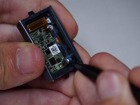

    5. Charge 3 Disassembly, Vibrator Shield: crwdns2935265:05crwdnd2935265:01crwdnd2935265:02crwdne2935265:0 Charge 3 Disassembly, Vibrator Shield: crwdns2935265:05crwdnd2935265:02crwdnd2935265:02crwdne2935265:0
      • Remove both T2 screws
      • Liftoff metal shield
    6. Charge 3 Disassembly, Main Shield: crwdns2935265:06crwdnd2935265:01crwdnd2935265:03crwdne2935265:0 Charge 3 Disassembly, Main Shield: crwdns2935265:06crwdnd2935265:02crwdnd2935265:03crwdne2935265:0 Charge 3 Disassembly, Main Shield: crwdns2935265:06crwdnd2935265:03crwdnd2935265:03crwdne2935265:0
      • Remove two T2 screws
      • Remove T3 screw

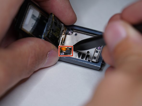

    7. Charge 3 Disassembly, Display Connectors: crwdns2935265:07crwdnd2935265:01crwdnd2935265:03crwdne2935265:0 Charge 3 Disassembly, Display Connectors: crwdns2935265:07crwdnd2935265:02crwdnd2935265:03crwdne2935265:0 Charge 3 Disassembly, Display Connectors: crwdns2935265:07crwdnd2935265:03crwdnd2935265:03crwdne2935265:0
      • Liftoff both display connectors
    8. Charge 3 Disassembly, Disconnect Connectors and Altimeter: crwdns2935265:08crwdnd2935265:01crwdnd2935265:02crwdne2935265:0 Charge 3 Disassembly, Disconnect Connectors and Altimeter: crwdns2935265:08crwdnd2935265:02crwdnd2935265:02crwdne2935265:0
      • Disconnect vibrator motor
      • Disconnect heartrate and charging connector
      • Remove altimeter

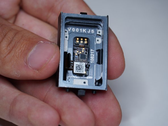

    10. Charge 3 Disassembly, Motherboard: crwdns2935265:010crwdnd2935265:01crwdnd2935265:02crwdne2935265:0 Charge 3 Disassembly, Motherboard: crwdns2935265:010crwdnd2935265:02crwdnd2935265:02crwdne2935265:0
      • Remove motherboard
      • It seems as if the heart rate sensor and charging pins are molded into the case, and I was not able to remove them

This tear down was very easy to follow. The heart rate monitor was also sealed in with some adhesive for me too but a little heat gun took it right off. I had suspected water leaked in and that in fact was the culprit after inspecting the connection. corrosion all around the HR monitor.
