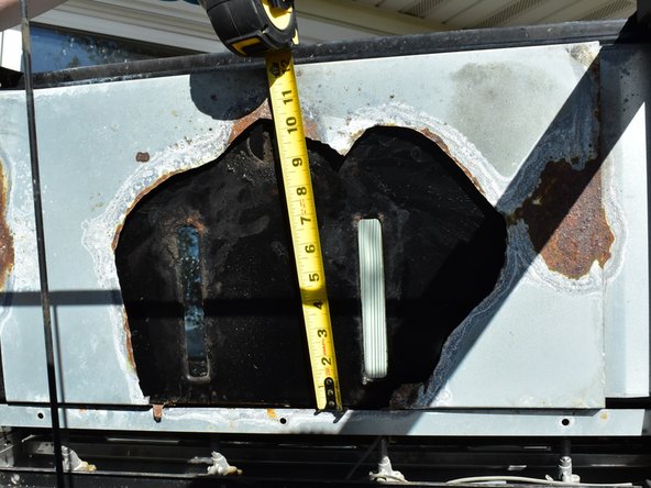

    • Make an initial assessment of the extent of the corrosion to the drip pan.
    • In this case, the middle of the drip pan was the most corroded, and the edges closest to the in-tact metal were less rusty.
    • Use a wire brush to remove the most corroded metal.
    • In this case, the middle of the drip pan was rusted through and was the most corroded.
    • Use the tin snips to remove the least corroded metal.
    • Assessing the corrosion on your drip pan is an essential step to determine which tool(s) to use to remove the decay.

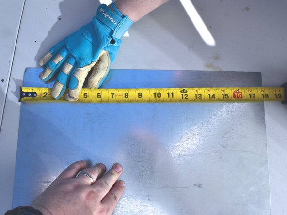

    • Measure and record the width of the drip pan opening.
    • Measure and record the height of the drip pan opening.
    • Measure and cut a piece of low gauge sheet metal to cover the dimensions of the drip pan opening.
    • Measure your new sheet metal to be a bit larger on all sides from the height and width of the hole.
    • You may purchase sheet metal by the piece at Lowe's or Home Depot and have it cut to the proper dimensions. The metal in this image was cut to dimension by an associate at Lowe's.

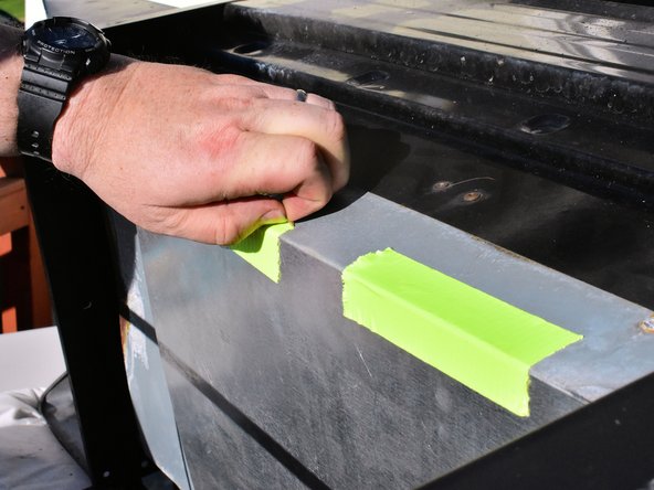

  4. Charbroil Gas Grill Drip Pan Repair: crwdns2935265:04crwdnd2935265:01crwdnd2935265:02crwdne2935265:0 Charbroil Gas Grill Drip Pan Repair: crwdns2935265:04crwdnd2935265:02crwdnd2935265:02crwdne2935265:0
    • Use your gloves for this step!

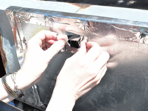

    • Position the cut sheet metal over the drip pan opening.
    • Use the duct tape to secure the metal in place for attachment with the self-drilling sheet metal screws.

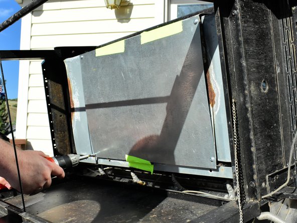

    • Use a power drill and the #10 x 1/2 self-drilling sheet metal screws to secure each corner of the replacement sheet metal.
    • Remove the duct tape when the sheet metal is secure.
    • Secure the remaining edges of the sheet metal with additional screws as needed to ensure a tight fit.

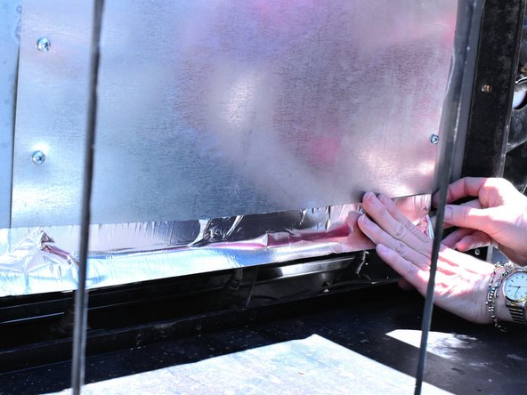

  6. Charbroil Gas Grill Drip Pan Repair: crwdns2935265:06crwdnd2935265:01crwdnd2935265:03crwdne2935265:0 Charbroil Gas Grill Drip Pan Repair: crwdns2935265:06crwdnd2935265:02crwdnd2935265:03crwdne2935265:0 Charbroil Gas Grill Drip Pan Repair: crwdns2935265:06crwdnd2935265:03crwdnd2935265:03crwdne2935265:0

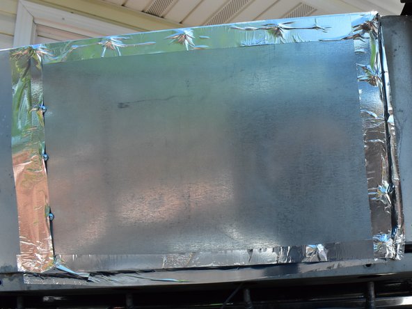

    • Ensure that the sheet metal screws have secured the replacement sheet metal patch.
    • Cut the 3M High Temperature Flue tape to the proper length (this will depend upon the size of the patch).
    • Place the tape over the sheet metal screws and cover the edges to seal the edges of the patch.

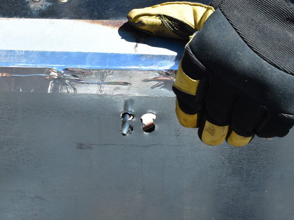

    • Drill four pilot holes through the grease outlet from the top side of the grill using either a cordless or power drill. These holes will be used later to provide space to use the tin snips.
    • Cut the remaining metal between the pilot holes with the tin snips to form a single grease outlet.
