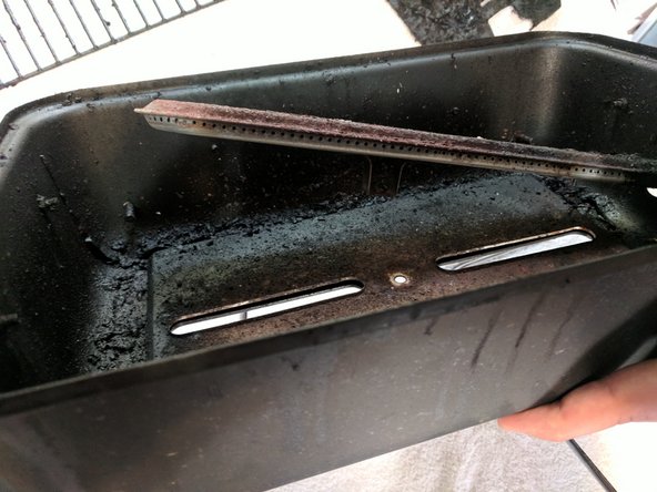

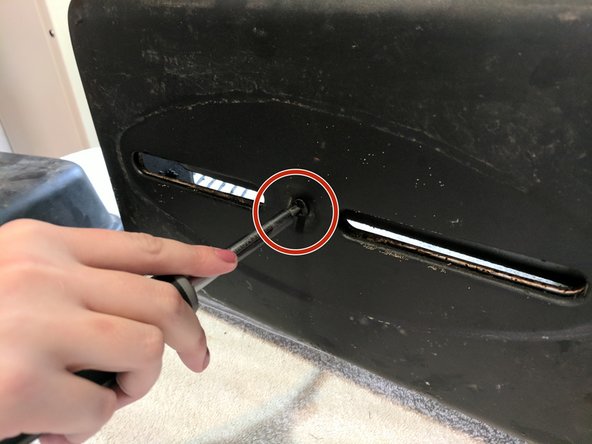

  4. Char-Broil Grill Burner Replacement: crwdns2935265:04crwdnd2935265:01crwdnd2935265:02crwdne2935265:0 Char-Broil Grill Burner Replacement: crwdns2935265:04crwdnd2935265:02crwdnd2935265:02crwdne2935265:0
    • Turn the stove on its side so that the bottom is easily accessible.
    • There is a single Phillips Head screw to remove in the center of the stove's bottom.
    • Fully remove this screw to detach the heating element from the main stove body.

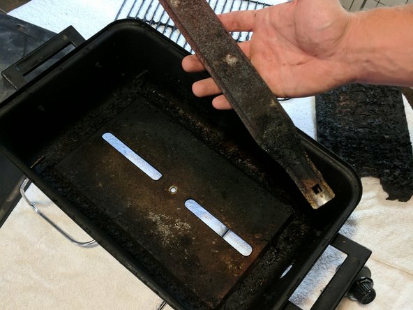

  5. Char-Broil Grill Burner Replacement: crwdns2935265:05crwdnd2935265:01crwdnd2935265:01crwdne2935265:0
    • Turn the stove back onto its legs after removing the bottom screw holding it.
  6. Char-Broil Grill Burner Replacement: crwdns2935265:06crwdnd2935265:01crwdnd2935265:03crwdne2935265:0 Char-Broil Grill Burner Replacement: crwdns2935265:06crwdnd2935265:02crwdnd2935265:03crwdne2935265:0 Char-Broil Grill Burner Replacement: crwdns2935265:06crwdnd2935265:03crwdnd2935265:03crwdne2935265:0
    • Before you can remove the heating element full you need to unscrew the propane vale on the exterior of the stove.
    • Pull up on the heating element, it should be free floating.
    • After the propane valve is unscrewed lift the old heating element out of the stove and replace it with the new part.
