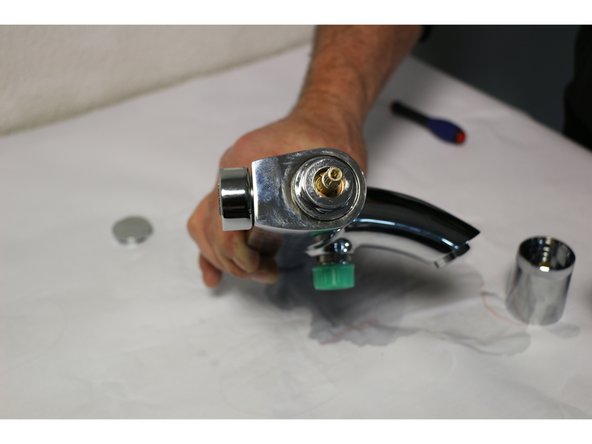

    • Unscrew the handle.

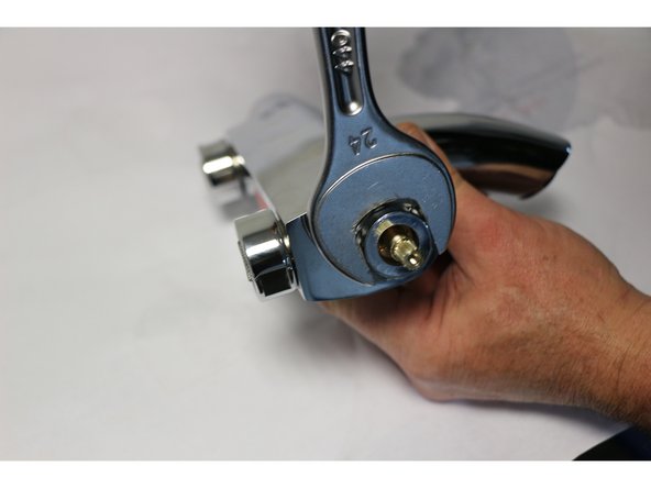

    • Using a 24 flat wrench, unscrew the nut counterclockwise.
    • Remove the inverter.

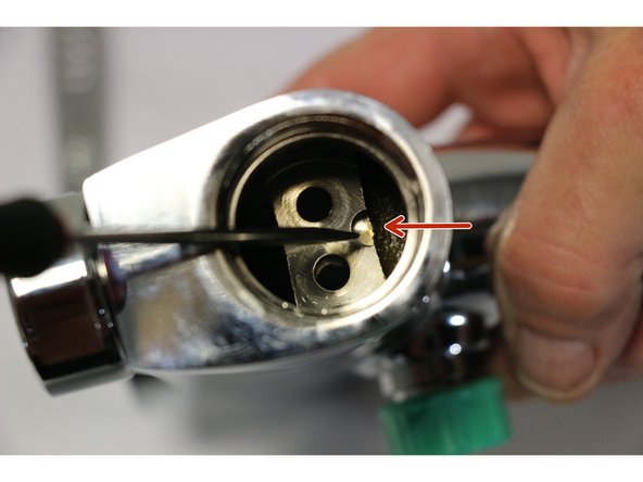

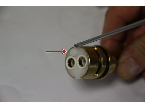

    • Please make sure to properly align the pin of the diverter with the notch indicated by the arrow in the body of the faucet.

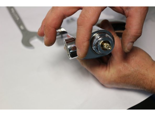

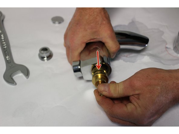

    • Insert the diverter into the body of the faucet.
    • Hand-tighten the inverter mounting nut clockwise.
    • Finish tightening using the 24mm wrench.
