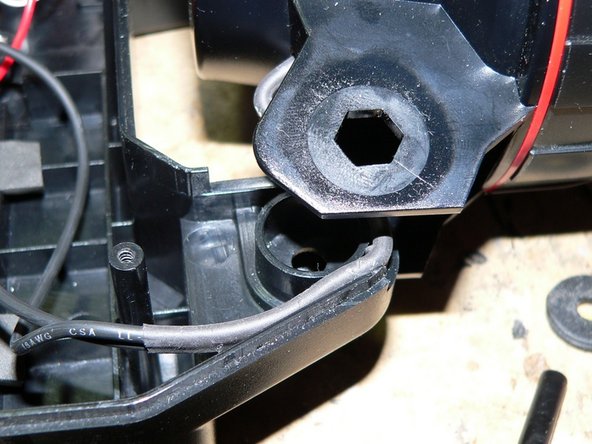

    • To dismantle, use a long crosshead screwdriver that will fit the screw heads properly. Remove the long screw that holds the lamp hinge together, remove the plastic hinge pin and pull off the lamp - this will require a fair amount of finger strength. Keeps the parts safe. Note the rubber washers between the pin flange and the brackets.

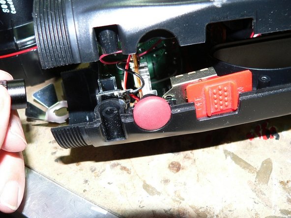

    • When the case is opened some parts may come adrift - note the red sliding switch fits over the switch component underneath. Also the pink button for the top lamp flashing function can drop out easily.
    • The cable for the main lamp fits between the hinge tube and the outside of the casing as shown in the third photo.
    • In the second photo just above the strap recess to left of the pink button switch, you can see a small horizontal metal contact - make sure this stays in this position, as it is the retainer for the top lamp bulb.

    • Reassembly is tricky - make sure everything lines up including the switches and small circuit boards, which fit in lugs inside one half of the casing. Use a small torch to look inside if neccessary. Make sure cables are not "pinched". If everything is okay the casing halves should fit evenly and easily.

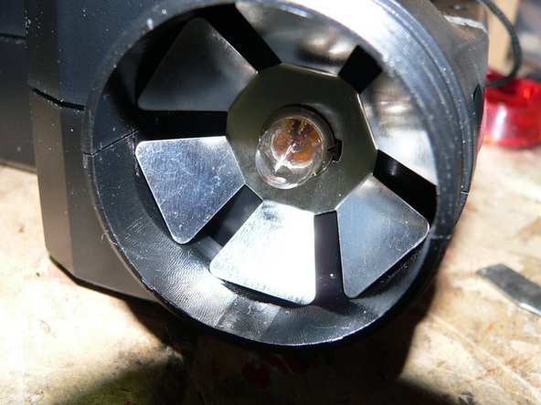

    • The second photo shows the reflector and bulb assembly for the top lamp. If you look closely on the right edge behind the bulb you will see a small metal "V" or claw - this holds the bulb in place. To remove the bulb, rotate it carefully so the claw clears the cutout in the flange and pull out.
