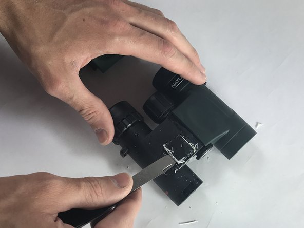

  9. Celestron Nature DX Anchor Arm Replacement, Anchor Arm: crwdns2935265:09crwdnd2935265:01crwdnd2935265:02crwdne2935265:0 Celestron Nature DX Anchor Arm Replacement, Anchor Arm: crwdns2935265:09crwdnd2935265:02crwdnd2935265:02crwdne2935265:0
    • Identify the panel on the side you wish replace the anchor arm on, as marked on the photo.
    • Cut the panel open with a knife. Cut the adhesive substance around the panel with the knife and then using said knife, you should be able to lift it off.

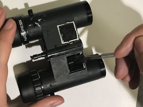

  10. Celestron Nature DX Anchor Arm Replacement: crwdns2935265:010crwdnd2935265:01crwdnd2935265:02crwdne2935265:0 Celestron Nature DX Anchor Arm Replacement: crwdns2935265:010crwdnd2935265:02crwdnd2935265:02crwdne2935265:0
    • Identify the anchor arm. It is circled in red.
    • Using the spudger, lift the anchor arm. It should come off without much resistance.
    • Insert the new anchor arm into the now open slot.
