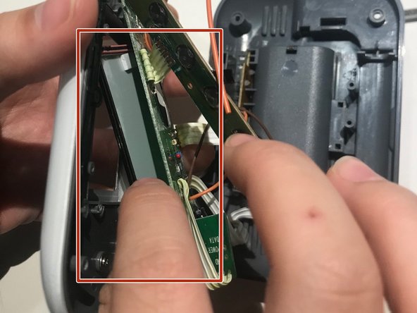

  2. Celestron HomeCast Lite 47020 Screen Cracked Replacement: crwdns2935265:02crwdnd2935265:01crwdnd2935265:03crwdne2935265:0 Celestron HomeCast Lite 47020 Screen Cracked Replacement: crwdns2935265:02crwdnd2935265:02crwdnd2935265:03crwdne2935265:0 Celestron HomeCast Lite 47020 Screen Cracked Replacement: crwdns2935265:02crwdnd2935265:03crwdnd2935265:03crwdne2935265:0
    • Be careful of the screw placed underneath the right-side white tab.
    • Once you have removed the screws from the cover, open the device carefully.
    • Use the Phillips #000 screwdriver to then remove all the screws inside the device.

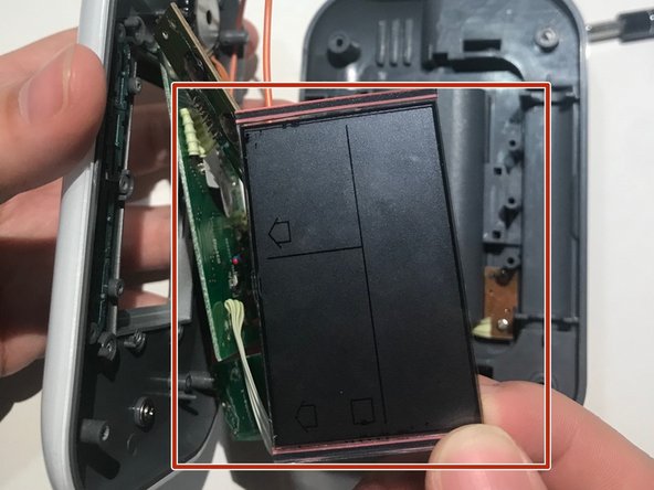

  3. Celestron HomeCast Lite 47020 Screen Cracked Replacement: crwdns2935265:03crwdnd2935265:01crwdnd2935265:03crwdne2935265:0 Celestron HomeCast Lite 47020 Screen Cracked Replacement: crwdns2935265:03crwdnd2935265:02crwdnd2935265:03crwdne2935265:0 Celestron HomeCast Lite 47020 Screen Cracked Replacement: crwdns2935265:03crwdnd2935265:03crwdnd2935265:03crwdne2935265:0
    • Be careful of all the connected white cables and wires when completing these next steps.
    • Remove the motherboard carefully to find the screen.
    • Remove the screen and check its condition.
