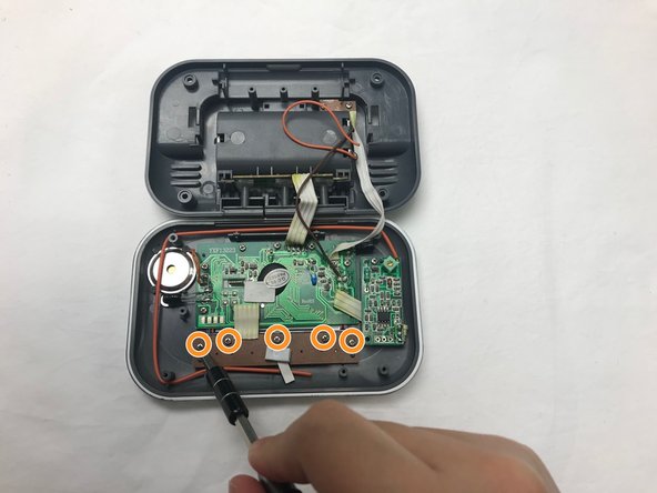

  2. Celestron HomeCast Lite 47020 Button Replacement: crwdns2935265:02crwdnd2935265:01crwdnd2935265:02crwdne2935265:0 Celestron HomeCast Lite 47020 Button Replacement: crwdns2935265:02crwdnd2935265:02crwdnd2935265:02crwdne2935265:0
    • Locate the brown rectangular control board.
    • Using the screwdriver, remove the five screws from the brown board.

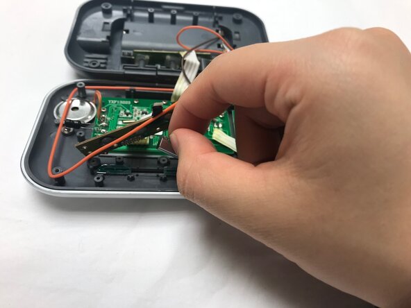

  3. Celestron HomeCast Lite 47020 Button Replacement: crwdns2935265:03crwdnd2935265:01crwdnd2935265:03crwdne2935265:0 Celestron HomeCast Lite 47020 Button Replacement: crwdns2935265:03crwdnd2935265:02crwdnd2935265:03crwdne2935265:0 Celestron HomeCast Lite 47020 Button Replacement: crwdns2935265:03crwdnd2935265:03crwdnd2935265:03crwdne2935265:0
    • Carefully remove the brown board to reveal the buttons.
    • Remove the buttons and replace with new buttons.
