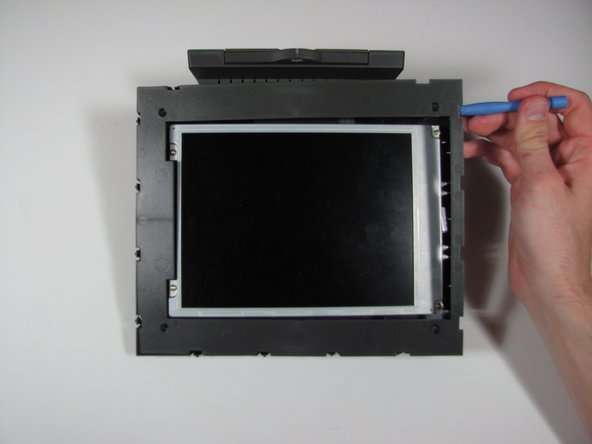

  5. Ceiva LF2003 Power Supply Board Replacement, Internal Plastic Screen Frame: crwdns2935265:05crwdnd2935265:01crwdnd2935265:01crwdne2935265:0
    • Remove the four 7mm Torx T6 screws.
  6. Ceiva LF2003 Power Supply Board Replacement: crwdns2935265:06crwdnd2935265:01crwdnd2935265:02crwdne2935265:0 Ceiva LF2003 Power Supply Board Replacement: crwdns2935265:06crwdnd2935265:02crwdnd2935265:02crwdne2935265:0
    • Using the plastic opening tool or your fingers, lift up the frame from any edge.
    • Remove the frame from the device.

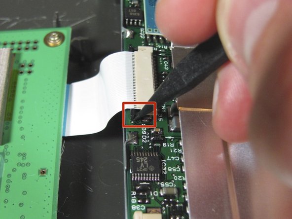

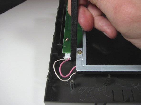

  7. Ceiva LF2003 Power Supply Board Replacement, Display: crwdns2935265:07crwdnd2935265:01crwdnd2935265:03crwdne2935265:0 Ceiva LF2003 Power Supply Board Replacement, Display: crwdns2935265:07crwdnd2935265:02crwdnd2935265:03crwdne2935265:0 Ceiva LF2003 Power Supply Board Replacement, Display: crwdns2935265:07crwdnd2935265:03crwdnd2935265:03crwdne2935265:0
    • Unplug the cable connecting the display to the power supply using the flat end of the spudger to pry the connector away from the circuit board.
    • Alternate applying pressure to the left and right side of the connector to ensure that it does not break.

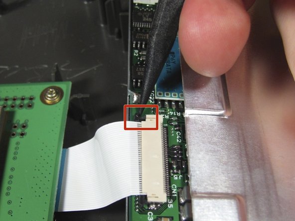

  10. Ceiva LF2003 Power Supply Board Replacement: crwdns2935265:010crwdnd2935265:01crwdnd2935265:03crwdne2935265:0 Ceiva LF2003 Power Supply Board Replacement: crwdns2935265:010crwdnd2935265:02crwdnd2935265:03crwdne2935265:0 Ceiva LF2003 Power Supply Board Replacement: crwdns2935265:010crwdnd2935265:03crwdnd2935265:03crwdne2935265:0
    • Use the spudger to disconnect the ribbon cable from the display by the black pins away from the connector. There is a pin on either side of the connector.
    • Once both pins are released, the ribbon cable should slide easily out.
    • It may be easier if someone else holds the display so the cable does not get ripped out.

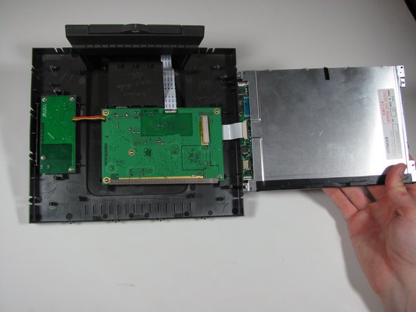

  11. Ceiva LF2003 Power Supply Board Replacement: crwdns2935265:011crwdnd2935265:01crwdnd2935265:01crwdne2935265:0
    • Remove the display assembly from the device.

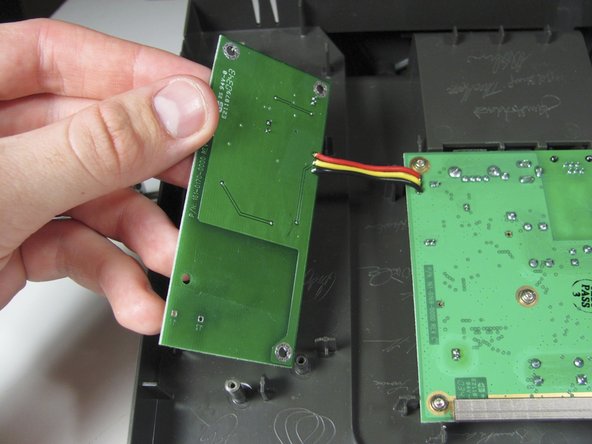

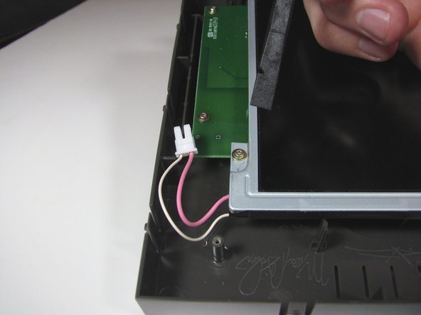

  12. Ceiva LF2003 Power Supply Board Replacement, Power Supply Board: crwdns2935265:012crwdnd2935265:01crwdnd2935265:01crwdne2935265:0
  13. Ceiva LF2003 Power Supply Board Replacement: crwdns2935265:013crwdnd2935265:01crwdnd2935265:02crwdne2935265:0 Ceiva LF2003 Power Supply Board Replacement: crwdns2935265:013crwdnd2935265:02crwdnd2935265:02crwdne2935265:0
    • Desolder the 3 wires attached to the board.
    • Remove the power supply board from the device.
    • The wires shown were not actually desoldered, but the board will now be separated from the rest of the device.
