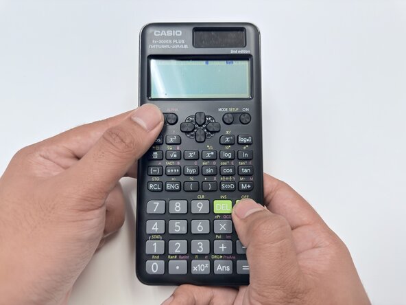

    • Press (Shift + AC) to turn off the calculator.

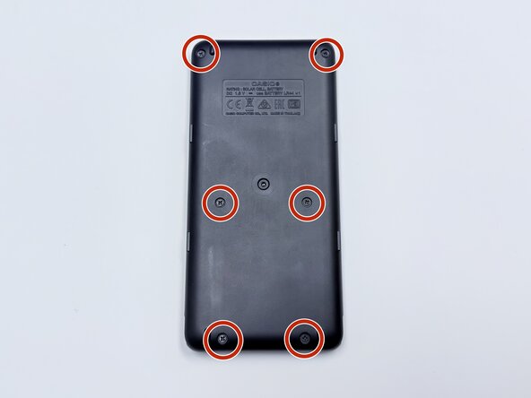

    • Use a Phillips #00 screwdriver to remove the six 7.5 mm screws from the back panel.
