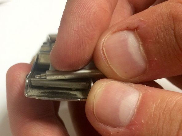

    • To add links:
    • Push both link pins back into the watch. Make sure to insert the link pin on the front side of the arrow.
    • Lightly tap a hammer until pins are flush against both sides of the watchband.
    • When adding links, be sure to insert the links at the same time as the link pins.
  5. Casio Watchband link replacement/repair: crwdns2935265:05crwdnd2935265:01crwdnd2935265:01crwdne2935265:0
    • For micro adjustments, push the Sim Card Eject tool into the adjustable side of the clasp. Carefully move pins to the correct fitting holes.
    • Do your best to not let the pins slip outside the metal clasp as they are difficult to get back in.

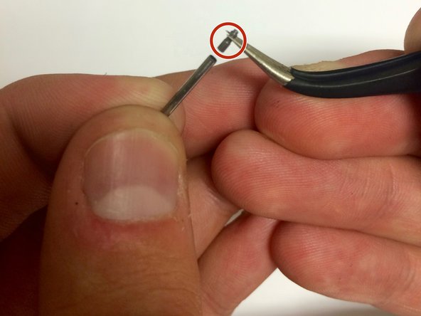

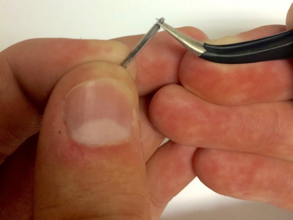

  6. Casio Watchband link replacement/repair: crwdns2935265:06crwdnd2935265:01crwdnd2935265:03crwdne2935265:0 Casio Watchband link replacement/repair: crwdns2935265:06crwdnd2935265:02crwdnd2935265:03crwdne2935265:0 Casio Watchband link replacement/repair: crwdns2935265:06crwdnd2935265:03crwdnd2935265:03crwdne2935265:0
    • Insert spring into the spring bar.
    • Insert the spring bar pin on both sides of the spring in the spring bar.
    • This is the spring bar pin.
