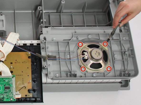

  4. Casio WK-220 Speaker Replacement: crwdns2935265:04crwdnd2935265:01crwdnd2935265:02crwdne2935265:0 Casio WK-220 Speaker Replacement: crwdns2935265:04crwdnd2935265:02crwdnd2935265:02crwdne2935265:0
    • Turn the speaker around and place on the keyboard keys.
    • Remove four 16 mm screws with a Phillips #2 screwdriver.
