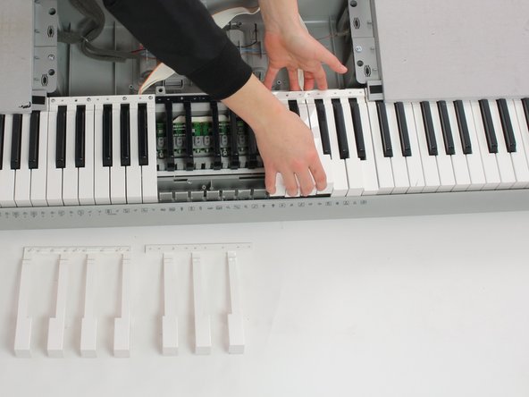

  6. Casio WK-220 Black Keys Replacement: crwdns2935265:06crwdnd2935265:01crwdnd2935265:03crwdne2935265:0 Casio WK-220 Black Keys Replacement: crwdns2935265:06crwdnd2935265:02crwdnd2935265:03crwdne2935265:0 Casio WK-220 Black Keys Replacement: crwdns2935265:06crwdnd2935265:03crwdnd2935265:03crwdne2935265:0
    • Remove 4 18 mm screws (circled in red) from desired key section using Philips #1 screwdriver
    • Gently push white keys away from screws and pull up to remove from keyboard. Repeat this with the black keys
    • Reassemble with new/cleaned keys
