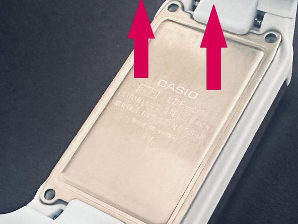

  2. Casio Poptone LDF-51 Series Battery Replacement Battery Replacement, Remove the Back Cover: crwdns2935265:02crwdnd2935265:01crwdnd2935265:02crwdne2935265:0 Casio Poptone LDF-51 Series Battery Replacement Battery Replacement, Remove the Back Cover: crwdns2935265:02crwdnd2935265:02crwdnd2935265:02crwdne2935265:0
    • Remove the back cover by unscrewing the four screws at the back using a J000 screwdriver
    • Take care not to strip the threads
    • Once all screws have been removed store them in a safe place
    • Carefully remove the back cover of the Poptone making sure not to flip the watch over
  3. Casio Poptone LDF-51 Series Battery Replacement Battery Replacement, Remove the Battery Replacement Sticker: crwdns2935265:03crwdnd2935265:01crwdnd2935265:01crwdne2935265:0
    • Carefully remove the sticker covering the back of the battery. We will be saving and re-applying it

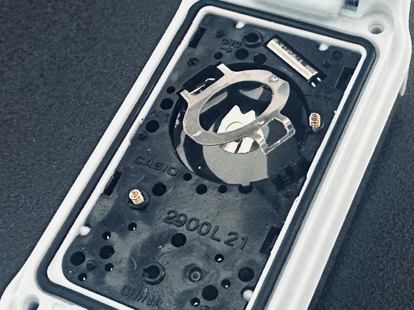

  4. Casio Poptone LDF-51 Series Battery Replacement Battery Replacement, Remove the Battery from the Holder: crwdns2935265:04crwdnd2935265:01crwdnd2935265:01crwdne2935265:0
    • To release the battery from the battery holder you will need to:
    • 1. Place your tweezers in the latch and pull in the direction of the green arrow. If you do not have a pair a tweezer, use a tack and place the tack between the latch and battery space and pull out
    • 2. Pull the latch all the way up to release the battery following the direction of the pink arrow
    • Be careful not to accidentally knock off one of the ground pins
  5. Casio Poptone LDF-51 Series Battery Replacement Battery Replacement, Replace the Battery: crwdns2935265:05crwdnd2935265:01crwdnd2935265:02crwdne2935265:0 Casio Poptone LDF-51 Series Battery Replacement Battery Replacement, Replace the Battery: crwdns2935265:05crwdnd2935265:02crwdnd2935265:02crwdne2935265:0
    • Now we can remove the battery from the latch
    • The replacement battery type is a CR1216 3V with the OEM battery being a Sony
    • Follow these steps in reverse to reseat the battery and complete the replacement

Does anyone know what to do if none of the buttons are responding on the watch? I knocked out 2 of the ground pins on mine (circled in red in the image) and put them back in as shown in the image. Is there only 3 total on the watch? I count 4 holes that you could put a ground pin in. Any help is greatly appreciated, thanks!
