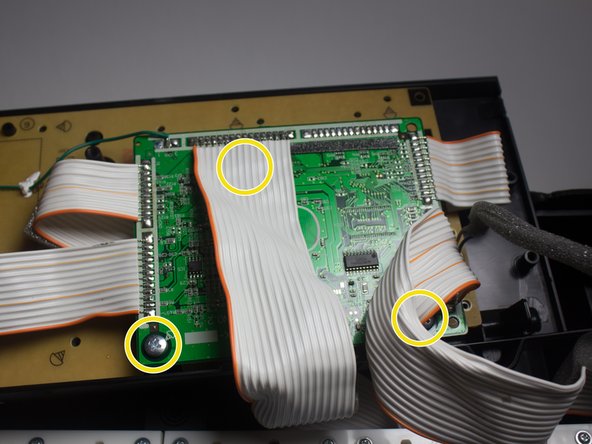

      • We will be removing a total of 26 screws on the component board..
      • First, you must use the PH-1 bit to remove the 17 8mm screws, circled in red.
      • Second, using the same PH-1 bit, you will remove the three 8mm screws hidden under the white wire. These screws are circled in orange.
      • Third, using the JIS-1 bit, remove the three 7mm screws on the circuit board.

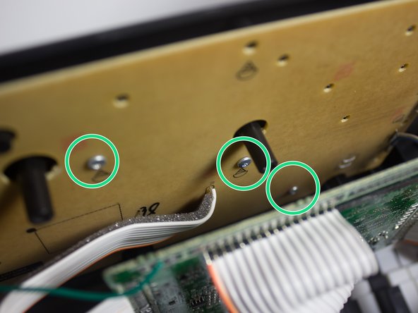

      • After removing the circuit board, three more screws will be revealed.
      • Using the PH-1 bit, remove the last three 8mm screws, circled in green.
