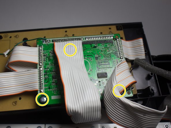

      • Then, using a JIS-1 bit, we will remove three 7mm screws from the circuit board, circled in yellow.

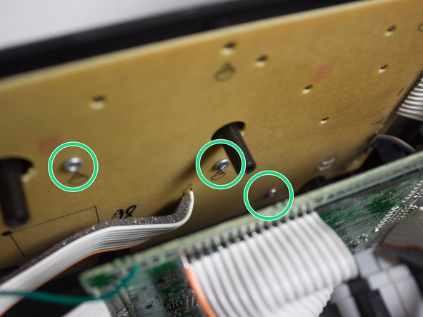

      • After removing the circuit board, the last three screws are revealed, circled in green. You will use the PH-1 bit to remove these last screws.

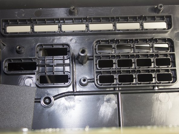

      • Under the panel are the buttons. Remove them by pulling from any corner with your fingers.
      • Remove all the buttons that need to be replaced.
