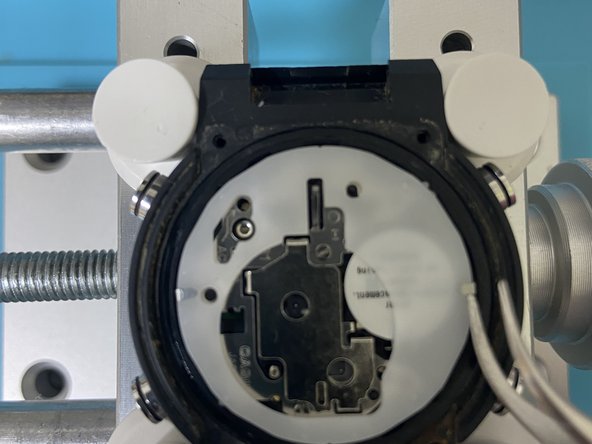

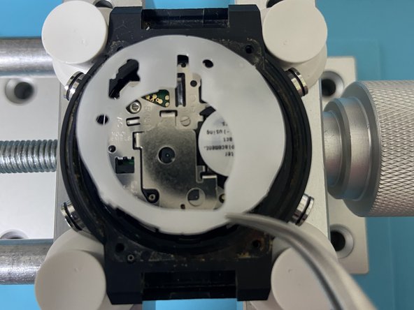

    • Next, bend two small clips upwards. They are fragile so be careful
    • Finally, remove the white plastic movement holder.
    • When removing it the whole movement might want to get out. One of the tricks to avoid that is gently keeping it pressed down through the hole in the middle while pulling the plastic upwards with tweezers.

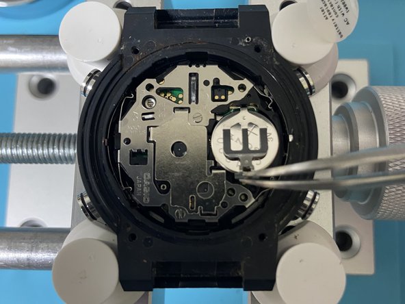

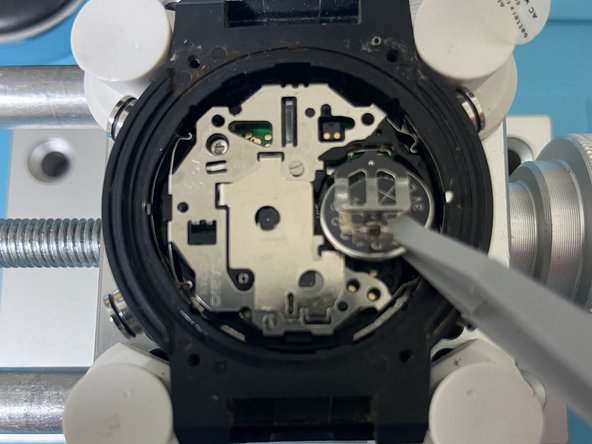

    • It is time to remove the old battery
    • Remove the sticker
    • Unclip the battery holder. Clip is under the tweezers on the photo
    • Remove the old battery. For this step you can use metal tweezers since there is little to no charge in the battery. I used plastic tweezers as the best practice.
  4. Casio G-shock GA-201 Battery Replacement, New battery: crwdns2935265:04crwdnd2935265:01crwdnd2935265:03crwdne2935265:0 Casio G-shock GA-201 Battery Replacement, New battery: crwdns2935265:04crwdnd2935265:02crwdnd2935265:03crwdne2935265:0 Casio G-shock GA-201 Battery Replacement, New battery: crwdns2935265:04crwdnd2935265:03crwdnd2935265:03crwdne2935265:0
    • Use plastic tweezers or your fingers to insert a new battery
    • One of the reasons why I made this post is because in some guides people used metal tweezers to insert a new battery. This will short it and potentially damage it which can result in watch damage as well.
    • Close the metal battery retainer and clip it back to the plastic clip

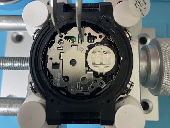

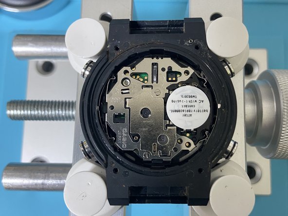

    • Next, we will read what is written on the battery sticker and do so
    • On the second photo you can see how to use metal tweezers to connect (-) to AC. AC is marked with the arrow on the metal shroud of the watch movement
    • It is not bad idea to flip the watch afterwards to make sure that it is working. Be careful that the movement doesn’t fall out of the case
    • For some reason on lots of tutorials people are just ignoring the note on the battery sticker. It is there for a reason so that is why this step is documented here
    • Returning sticker back to its place so that the next person who will be doing the replacement know what to do

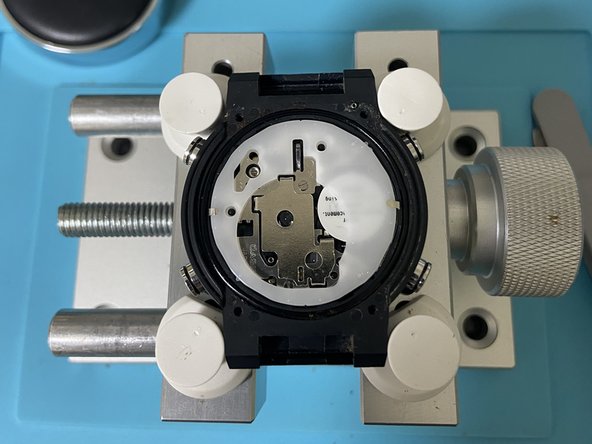

    • Put the white plastic movement holder back to the case and bend the two small metal retainers down
    • Put the lubricated gasket in its groove on the watch body
    • Put the lid back on and screw down the 4 phillips head screws

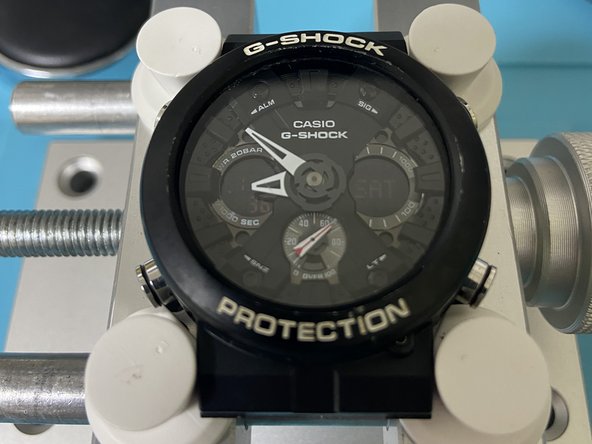

    • All done. Just have to install the strap and shroud back and it is ready to serve its owner for years to come. There is also a step of setting time and date, but it is well documented in the product manual so no need to write the steps here as well.
Changing batteries on the watch is relatively easy task if you do necessary precautions. Just make sure not to short the new batteries and to reapply the grease on the gasket. While lots of watches require specialized tools to open them, G-Shocks are quite easy to open with regular tools making them great beginner watches for learning about basic quartz movement maintenance.
