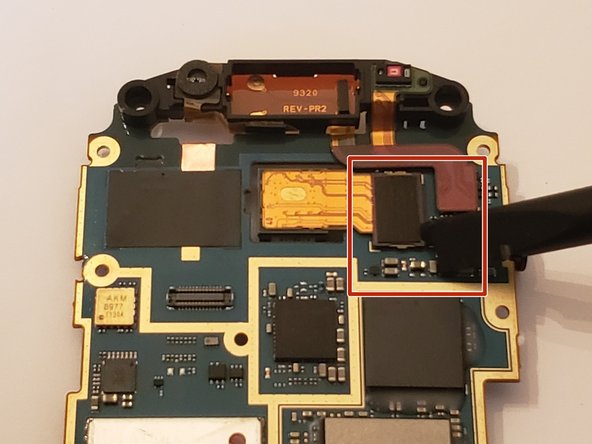

  8. Casio G'zOne Commando Verizon MIL-SPEC Camera Replacement, Camera: crwdns2935265:08crwdnd2935265:01crwdnd2935265:03crwdne2935265:0 Casio G'zOne Commando Verizon MIL-SPEC Camera Replacement, Camera: crwdns2935265:08crwdnd2935265:02crwdnd2935265:03crwdne2935265:0 Casio G'zOne Commando Verizon MIL-SPEC Camera Replacement, Camera: crwdns2935265:08crwdnd2935265:03crwdnd2935265:03crwdne2935265:0
    • Using a spudger, gently lift up the orange connector.

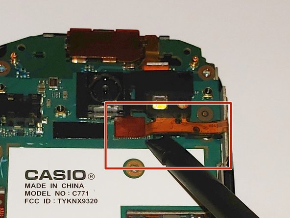

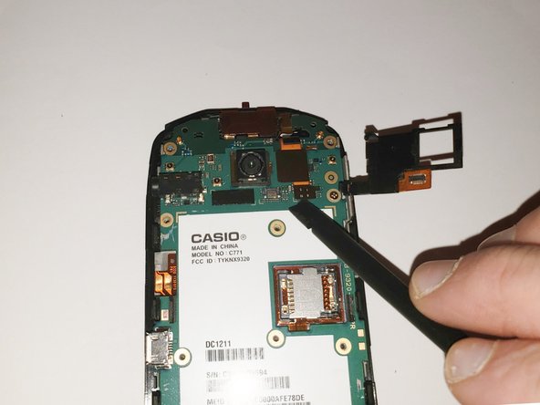

  9. Casio G'zOne Commando Verizon MIL-SPEC Camera Replacement: crwdns2935265:09crwdnd2935265:01crwdnd2935265:02crwdne2935265:0 Casio G'zOne Commando Verizon MIL-SPEC Camera Replacement: crwdns2935265:09crwdnd2935265:02crwdnd2935265:02crwdne2935265:0
    • Flip over the motherboard
    • Using a spudger, lift up the small black connector and remove the camera.
