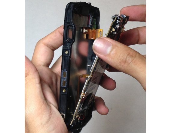

  7. Casio G’zOne Commando 4G LTE Volume Buttons Replacement, Motherboard: crwdns2935265:07crwdnd2935265:01crwdnd2935265:02crwdne2935265:0 Casio G’zOne Commando 4G LTE Volume Buttons Replacement, Motherboard: crwdns2935265:07crwdnd2935265:02crwdnd2935265:02crwdne2935265:0
    • Gently remove the motherboard with the spudger.

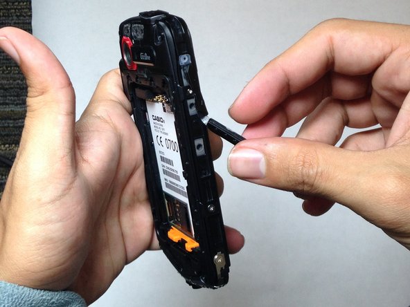

  8. Casio G’zOne Commando 4G LTE Volume Buttons Replacement, Removing external volume pads: crwdns2935265:08crwdnd2935265:01crwdnd2935265:02crwdne2935265:0 Casio G’zOne Commando 4G LTE Volume Buttons Replacement, Removing external volume pads: crwdns2935265:08crwdnd2935265:02crwdnd2935265:02crwdne2935265:0
    • Following step 4 in the prerequisite guide, remove the volume pads located on the side of the phone with a gentle pull.
